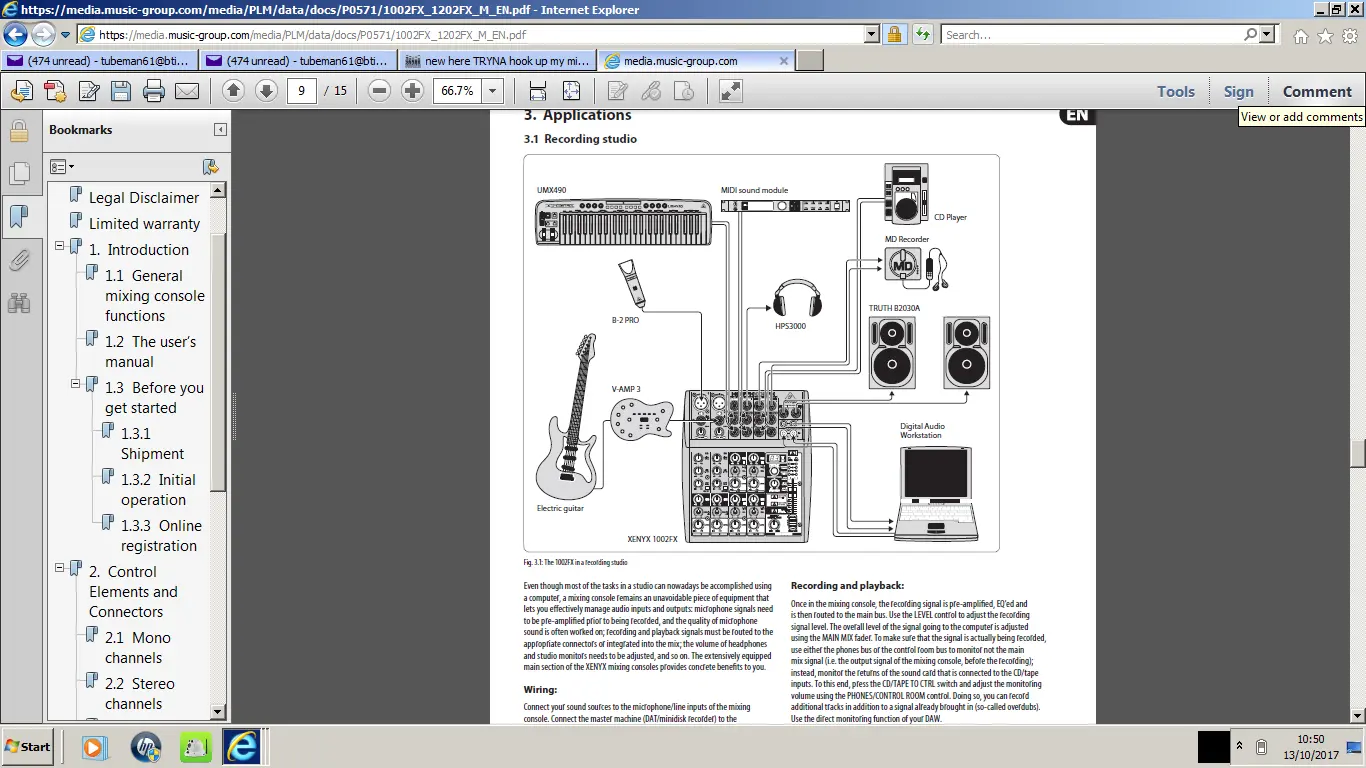

The attached shows how to connect the gear.
The Sound Module would be the second keyboards audio feed.
The 'Mini Disc' feed would (probably*) go to the F'rite.
The return shown from a CD player MIGHT be handy as a replay from the 2i2 but see *.
*Much depends on how you intend to work. If using live mics for example you will have to use headphones and rig things to avoid feedback..But 'it'appen! Things WILL hum,fart, feedback. Called "learning".
One crumb of comfort? No matter how you cockup or what noises you make you are very unlikely to damage anything. Modern gear is very forgiving, yes, even Bellringers!
