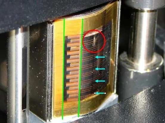

BUT...look at my edits to one of your pics of the head. I circled a suspect spot in red....man! is that starting to gap or is it just very close to the gap?? Then the blue arrows show the gap line all the way down...not saying that it is never visible, but that just doesn't seem right to me for a new head. And then the green lines...the line on the left is parallel with the edge of the stack of elements and bands, the one on the right follows the line of relief you can see on the polished surface of the head. They aren't parallel to each other and they should be...the grind of the head does not match the overall block, and therefore the zenith is automatically going to be whacked, which is a real issue because the zenith is fixed on TSR-8...the face of the head has to be right or the zenith is off...

Ah, the mystery deepens and there's the question of what is the source of that head. There's actually more questions than answers, as to what happened between the time Matt sent the head-stack in and received it back but I do agree that this head is not right. Is JRF ultimately responsible for a possible error or oversight? I think so. If John actually checked the head out prior to sending it back, mounted and aligned, then he would have spotted the obvious problem, easily seen in the above photos.
I'm looking at my modded picture from a different mental vantage-point and the glint in the red circle may just be a reflection...:confused:...but that gap band is visible in other pictures you put up, 'chute...and the disparity between the axis of the block and the axis of the polished crest of the face really doesn't look right.
I can't touch John French in knowledge or experience of these matters...absolutely not...I want to make it clear that any and all of my comments should be taken as opinion, but I have tweakered enough in the last two years to (I feel) understand the mechanics of the tape-to-head relationship, and my experience is almost exclusively with that very Teac head...I've got 8 of them at my place between my 48 and 58 and their parts decks in various states of wear, though nearly all are relatively low hours, and none have been relapped that I can tell, and I think all have a more pronounced peak to the crest of the head face...dunno...
If I get a chance I'll measure the distance from the bottom of an edge-relief slot to the peak of the head on one of the heads on my 48 (which are the least worn of any of my heads) and put it up here. If you get into a tussle with JRF :( which would just be an absolute shocker and you have access to a dial caliper you can do the same and that may shut the door on the debate as to whether or not the head is new and defective, or used and poorly relapped.

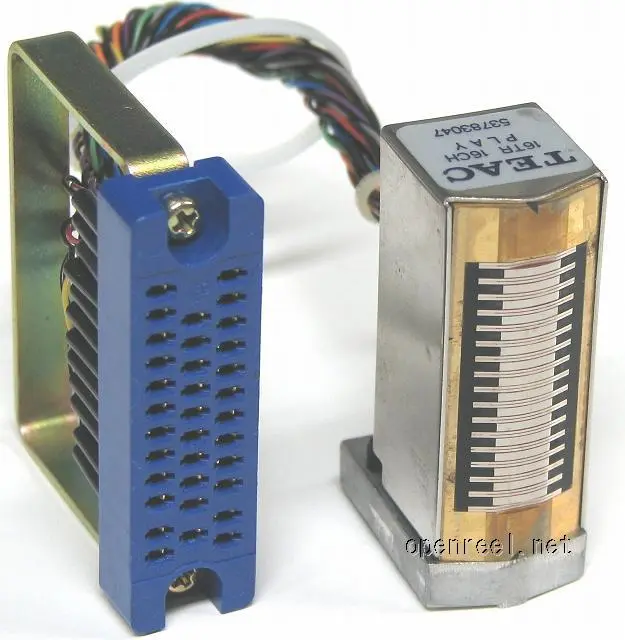

From what I can see on Sweetbeats photos the head on my TSR-8 is very similar & more of a square profile with the corners angled across / inwards.
The photos of Poopchutes head are different & more of a rounded shape, my Fostex E-16 heads (90%+ according to the service guy) are the same style / profile, but Fostex new head pictures I've seen are exactly the same.
Most of the Tascam 8 track heads I've seen pictures of seem to have the same profile I've mentioned above?
I've attached a photo of a 1" tascam 16 track head at first look it appears more rounded but a closer look reveals the more square profile of the 8 track Tascam heads
Yup, I can certainly vouch for the "square profile" mentioned above. I have my share of inspecting and photographing 58 and 48 heads and they never looked round as in Matt's photos. There is a slight flat top to 'em but never absolutely round. The latter is usually seen in lapped heads.

Sweetbeats, I believe that the thing you circled in red is just a reflection. I cannot see it with a magnifying glass. The only real problems I saw were the Brass reflections...the fact that the tip appeared to be over to the right side of the head (as if it was sanded off center) and that I tought that "NEW" heads had a more pronounced tip to them kinda like an eraser.

just for the record, was he able to identify those markings in the first photo you posted? i'm curious how something like affects head performance (or if it's primarily cosmetic).
Well he hasnt really said one way or the other what he thinks the marks are. But I just got another email back and he is now saying he might try to polish the marks out. I emailed him back saying that I prefer a different head and that I didnt think the brass marks would polish out as they appear to be beneath the surface.
