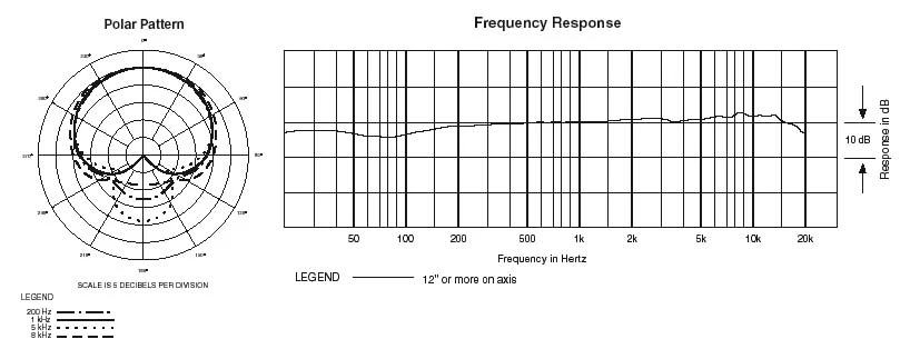

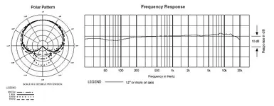

No frequency response plot, no shockmount, no pad, no rolloff. Audio technica are not very straight forward with their quoted frequency responses - the plot often tells a different story to the quoted figure. 20Hz-20kHz coulde be measured +-20dB. I reckon you'd be much better off with a used 3035 with shockmount - I picked up my pair for $80 and $110(with cable).
Here's the frequency plot.
The capsule is electret, doesn't give a size. The mic is 6 inches long and 2 inches in diameter - mic manufacturers put little 1/2 inch diaphragms in big side address mic bodies and people think they're buying a LDC. Looks like this is more of the same dishonest BS - though doesn't necessarily mean it's a bad mic.
Buy one and let us know.

Cool, where did you find that? It doesn't look too bad at all. Audio technica use the same capsules in a lot of their mics I wouldn't be surprised if this is the same capsule used in the MB4k.
