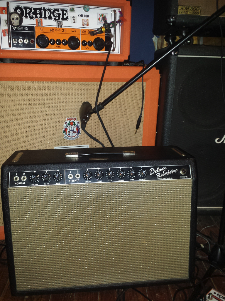

I think the reverb is messed up - it sounded OK in the store but now I think maybe the springs are hitting the inside of the tank or something.
I've had that happen with a Fender spring reverb tank. Give it a giggle and it's fine for a while, then happens again. I'm thinking the springs lose their tautness and start to sag.

The amp in the foreground is not loud. The amps in the background are loud. (sorry, Greg's not here - somebody's gotta do it)

I'm kind of reluctant to say it (because of my reflexive loyalty to the British amps), but this Deluxe Reverb might have the best lead sound of any amp I've ever played - sounds great even completely dry and at low volume - much better when cranked of course, and I haven't tried much in the way of pedals yet. I'm hoping to be able to post some clips this weekend.
edit: I'll backpedal a little - this is partially a function of the size of the room I'm in (small) being well matched to the Deluxe -- the Marshalls both need to be cranked to get into their zones - especially the NMV one (details in other threads - these are a 2204-circuit JCM 800 (MV) and a 1987-circuit JMP 50 (NMV)). The Orange (pictured, which is pretty new) can sound good to me at lower volumes, but also likes loud. But still - the DR...

I took out the reverb tank and discovered it was brand new - I think the bag it was in had a wrinkle in the bottom that was pushing the spring assembly up against the top of the tank. Anyway, I went to the store, and they dampened it a little with some foam. (they also said they had replaced the original because the springs were really saggy) Much better now, but I'm still not completely in love with the reverb sound, except for when it's at 1 or 2.
I found out the owner of the store got the from a single owner who bought it at a music store here in town way back when. He played in a high school band in the 60s, then the amp sat in a closet for decades

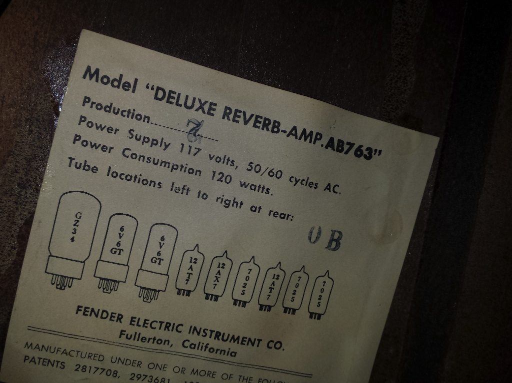

I did some more research, and I think it's actually a 1965 model, not 1964 - a transformer in it has a 1964 date code (so they said at the store - I'm still learning) but the code on the tube chart is "OB" - which after some web searching, I think means February of 1965:
that would make this a CBS era amp by a week or two, I suppose, or maybe among the very last of the pre-CBS amps, depending on how you look at it.
