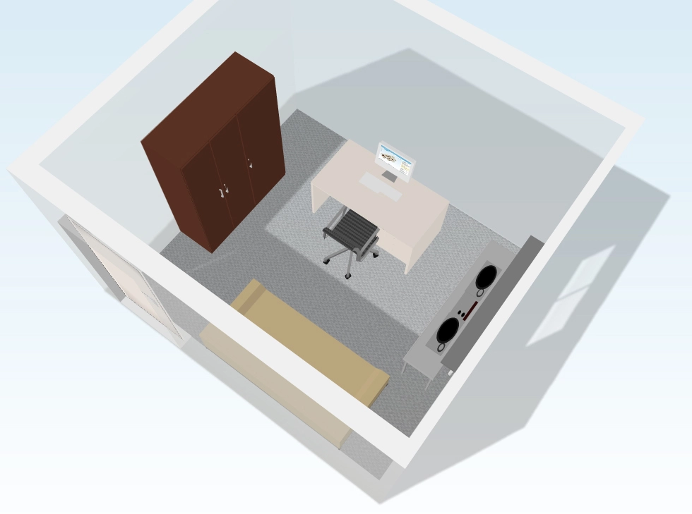

As you can see on the attached picture, the window is not in the middle and under the window there is a windowsill.
At the moment my studio monitors are placed behind the window and the bass reflex ports are going straight to the windowsill, which isn't a good choice regarding the acoustic I guess.
Where is the perfect position for my monitors? Bass traps? Any suggestions?
Size is: Left side: 383cm, Top: 340cm // 13,4 m2

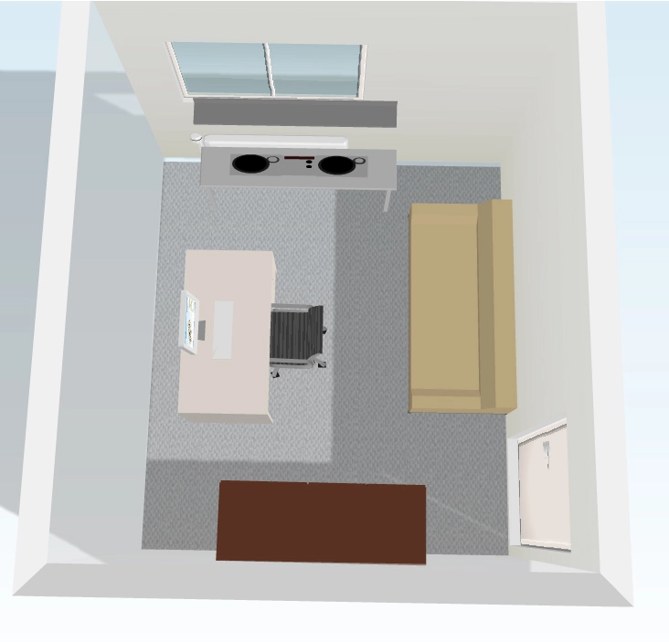

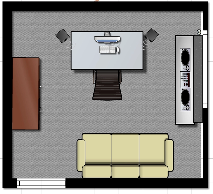

Thank you for your quick reply's, but look at the right bottom at the door. There is not enough place for a bass trap. It's less than 10cm.
I also have to install a small couch, a dj console and a wardrobe.
So I tried out something could this work for me?
I have to admit, I didn't know where j69's 2.7' measurement came from... So I was going with the .38 on the mix position (4.75') which will give him a pretty darn small spot, but with enough trapping it could work.
I don't envy that space though... I was in a space like that for a while (as this room was being built actually) and it was a nightmare of epic proportions even with a truckload of trapping.
(EDIT - NEW POST FROM OP)
Ideally, you're going to want to be facing the other way (facing the short wall). That said, trap the crap out of it and see what happens. And keep in mind from the start that you're in an acoustic nightmare from the word "go" on this one. Any chance at moving that door a meter down the wall?
