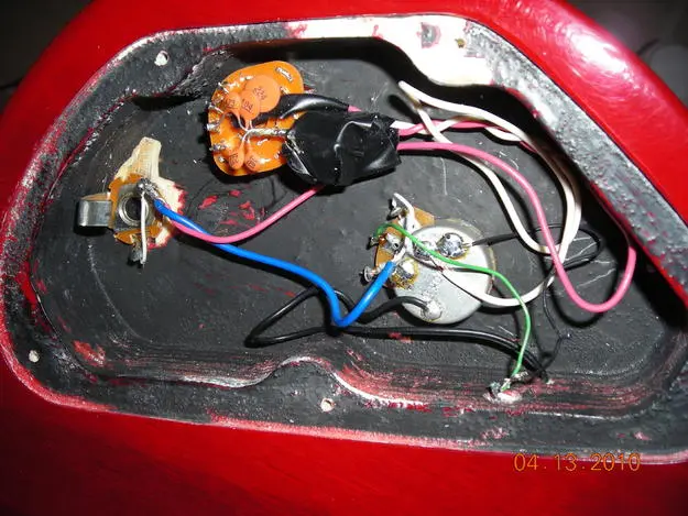

I have an epi sg jr which I have installed a varitone switch in. I'm sure I have the switch wired right as the directions are simple (red wire to the input jack, white to the back of vol. pot.). The volume originally had the blue wire going to the tone pot. but nothing direct to the input jack. So after taking out the tone pot. I figure just go direct to the input jack. I'm including a pic (hope it shows up), can anyone help me?

Hard to tell what's going on behind that....NO!...:eek:...that's NOT electrical tape, is it!
C'mon...do it right, get some heat-shrink tubing. That electrical tape will just get gooey and eventually come apart...YUK. :D

Ooops, forgot to say the problem is no volume. (The electrical tape on the varitone switch is not my doing.)
There is a red wire from the varitone switch to the hot side of the input jack. A white wire from the varitone switch to the back of the vol. pot. The blue wire is from the vol pot to the hot side of the input jack. I sort of wound it together with the red wire of the varitone switch. There is a white wire that connects both terminals of the input jack (doesn't make sense to me, but I'm no electrical genius and that's the way it was originally). The other wires connecting to the vol. pot come from the pickups and they were already wired like that.
Just a note, I had volume until I installed the varitone switch and messed with the blue vol. pot wire. I'm not master solderer either, so maybe the solder job to the input jack is not good enough?
Is it just me or is your tip and sleeve on the input jack jumped together? Sure looks like your signal is grounded out....but even then I see no wire going to the tip anyways.
Outlaws, you are correct, the white wire goes from the tip to the sleeve of the input jack (that's what you call those terminals?). That's the way it was before I put in the varitone switch and the volume worked fine. The blue wire from the vol. pot and red wire from the varitone both go to the hot side of the input jack (is that the tip or sleeve?). As you can see I barely know what I'm doing, but can easily follow diagrams and directions. The only thing different about the wiring, excluding the varitone switch, is that the blue wire is now going directly to the input jack. So what is the problem?

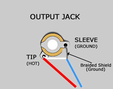

Does the BLUE wire actually have a shielded center wire (WHITE) with a naked braided wire (which is actually a ground wire)...?
That's what it looks like, but the picture is not very clear.
If that is the case...then the center white wire should be, and appears to be...going to the TIP of the jack, while the naked braided ground is tied to the SLEEVE.
Your RED wire is then in the wrong place...it needs to be where the TIP/BLUE(center WHITE) wire is going...the TIP...in the picture it looks like you have it going to the SLEEVE.
The TIP and SLEEVE should NOT be connected in any way or have the exposed wires touching each other.

Miroslav, thanks for pointing that out about the shielded white wire coming out of the blue. I didn't notice it, but looked at the vol. pot and sure enough the white wire is actually coming out of the blue.
Now on the input jack, the white wire was definitely all by itself going from tip to sleeve. The blue wire originally terminated at the now removed tone pot.
So in the pic, which terminal on the input jack is the sleeve and which is the tip? Where I have the blue and red wire connected to now is where the red wire from the tone pot. went to.

... I got a feeling the white "hot" wire in the shield got tied to ground inadvertantly.
Yeah...that's why I asked him for a close-up from the side.
Also...I think he wired the red to what is really the Sleeve.
Anyway...here's how it should be IMO (99% sure):
The jack in the image is oriented almost the same as the one in your picture above...the TIP on yours is the leg pointing south

I think I thought that the white wire was going from the tip to the sleeve when I first started messing around not realizing as Miroslav pointed out that it actually came out of the blue wire. So now I've got it all set up the correct way. I had no idea (obviously) which was the tip and which was the sleeve, but after everyone helping and some close examination I understand now. By the way arcaxis, I have no clue how to read a wiring diagram, just illustrations such as miroslav drew. Hey, at least everyone saved me some money in wiring this and that is my goal from now on. Thanks so much!!!
