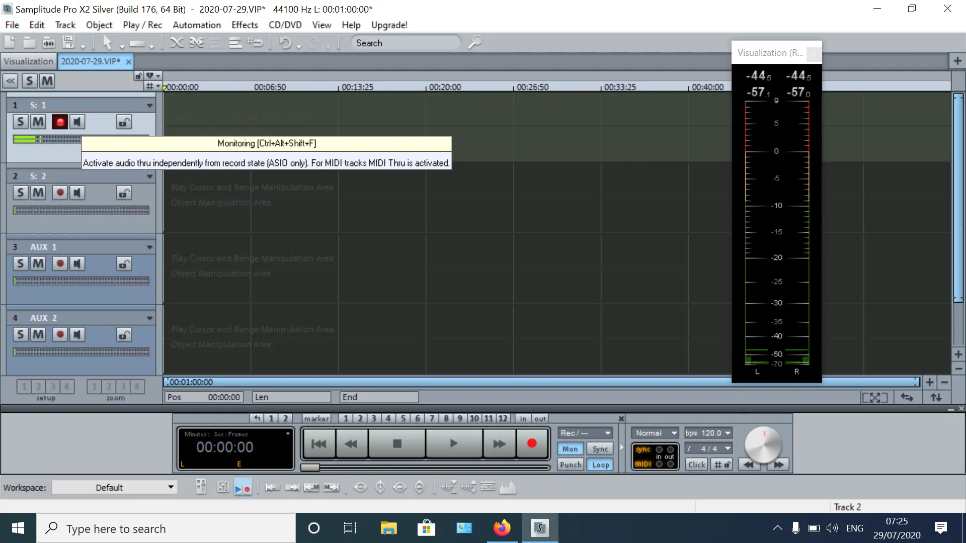

See the 'speaker' icon in attached? That is from Samplitude but virtually all DAWs have such a monitor button and if engaged can, in some circumstances give an echo effect.
