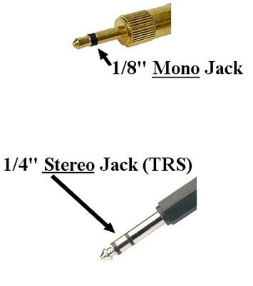

Look at any and all cables and/or extensions going from the headphones to whatever the headphones plug into. Look at the picture below. All cables and extension cables should have a stereo(TRS) connector. If one doesn't, you'll only get mono(unless you partially unplug it. That's for another day), regardless of size.

Well, I finally got it to work. It must have been a bad 1/4" adapter, cuz i got new headphones, and i plugged em in with the adaptor that came with them and it worked right away!
