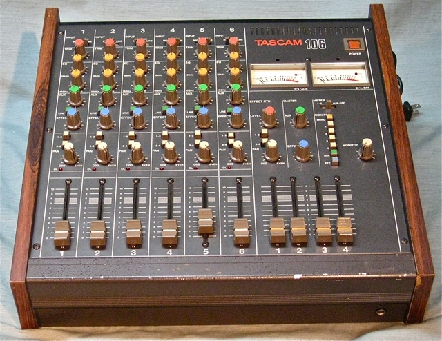

I have a 1002fx with the rotary levels and it is fine, unless I'm doing two things at once : ) In that regard, pulling out the old Tascam m-106 has space between controls that almost give 3rd-eye accesability
