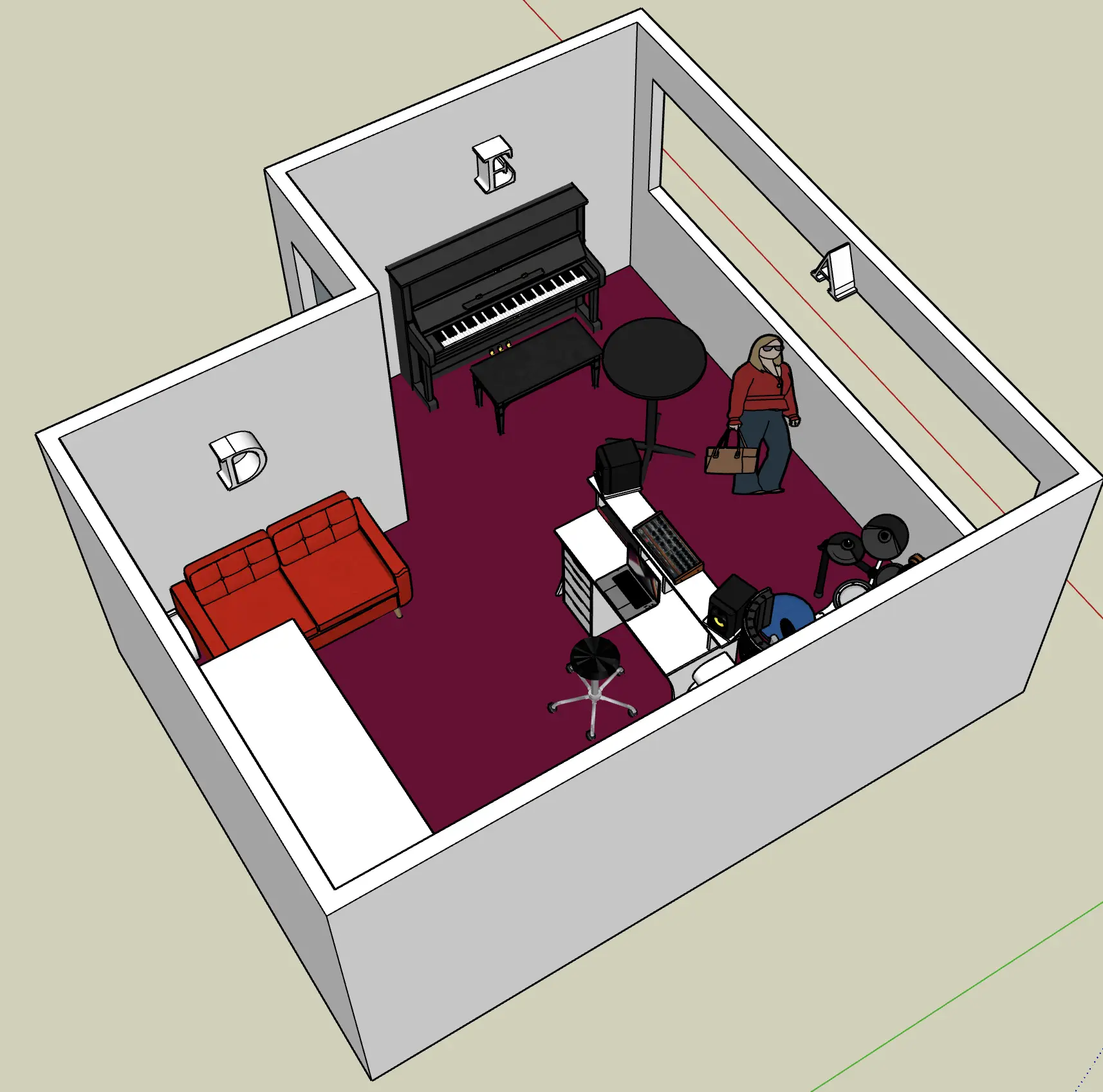

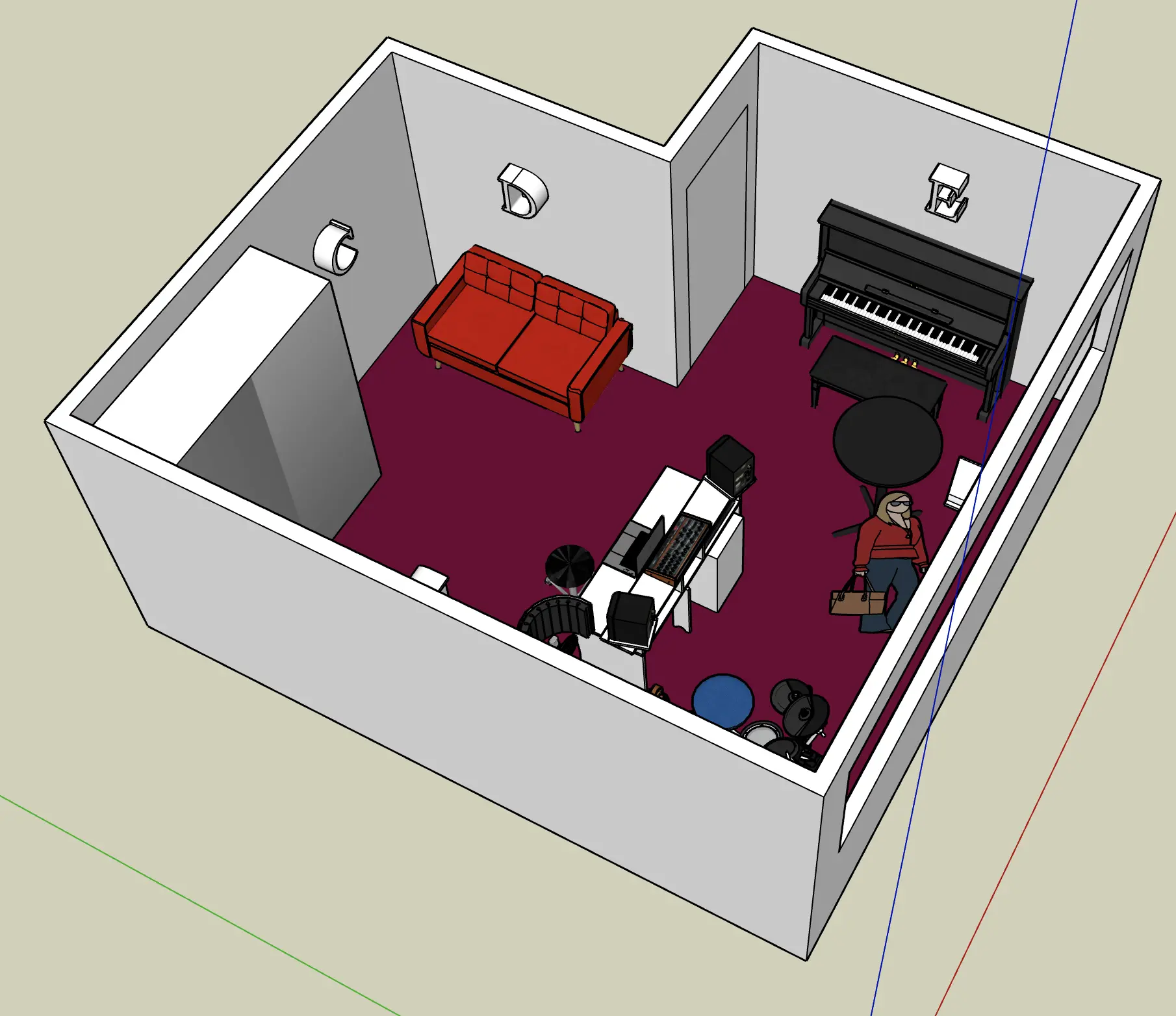

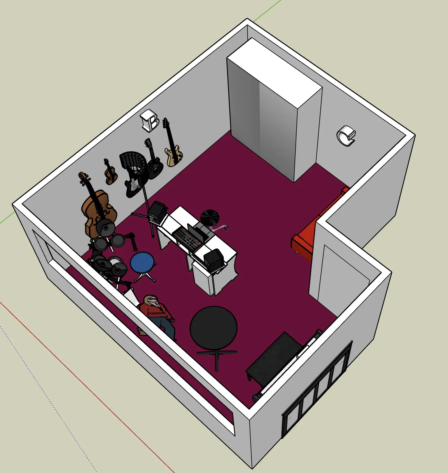

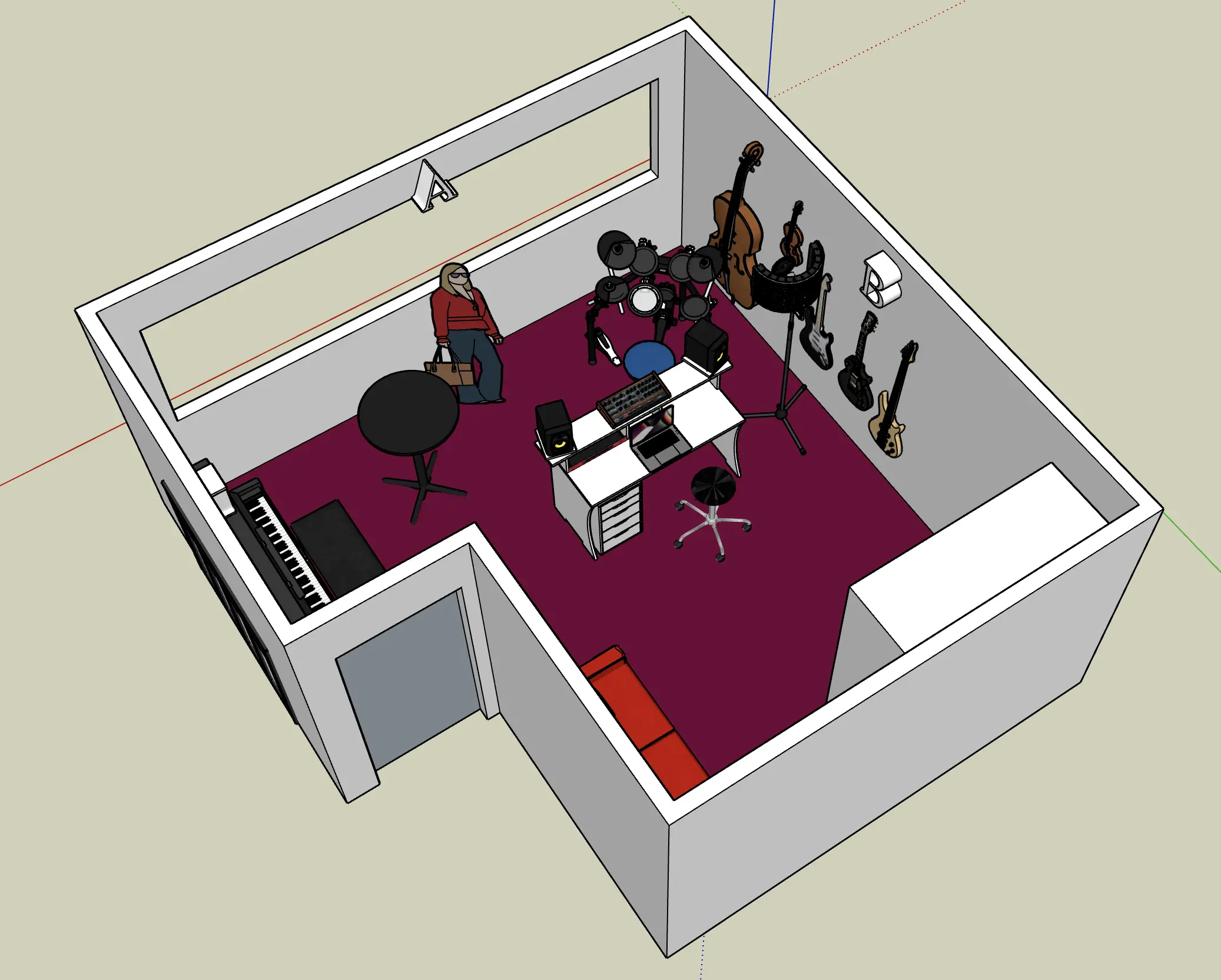

I'm trying to build a studio. The function of the studio is primarily to mix rock and electronic music, but also to be able to record voice/instruments, one at a time. Furthermore, my wife will use the bar table to record podcasts with guests.
You can see the layout of the room and the different furniture in the uploaded photos (I've called the walls A-E). I'm really a beginner so I'd really appreciate all your input on how to treat the room and where to place the different furnitures. The walls and roof are made of plaster on thick walls (wall D is made of concrete) and the room per se is already relatively sound proof, so that's not my concern. I'm really more interested in taking away most room reverb and maybe diffuse the sound. So my questions are:
1. Where to put the studio work station with the monitors, regarding the windows, the shape of the room etc.
2. What to do about the windows and the mirror doors of the closet- they reflect a lot of sound right?
3. Where to put absorbers and diffusers?
4. Is it okay to have the instruments (piano, guitar etc) in the room or will it generate reverb as well? The drums are electronic.
Thank you all!

A dimensional drawing would help. What is that boxy shape against wall 'C' that the desk is facing - a wardrobe? Can you move it? That would be the best place for your desk. Symmetry is important when setting up a mixing space. Bass traps in all corners. Forget diffusors (read the 'Small Room Acoustics' thread in this section of the forum).

Yep the boxy thing is a wardrobe. Kind of hard to move, but it's possible.

Do you need it in that room at all? It just makes it harder to situate everything else in the room. For the window wall (A), heavy drapes will help, and bass traps in front (wall C) and back (wall A) corners, floor to ceiling.
Again, a dimensioned drawing would help.

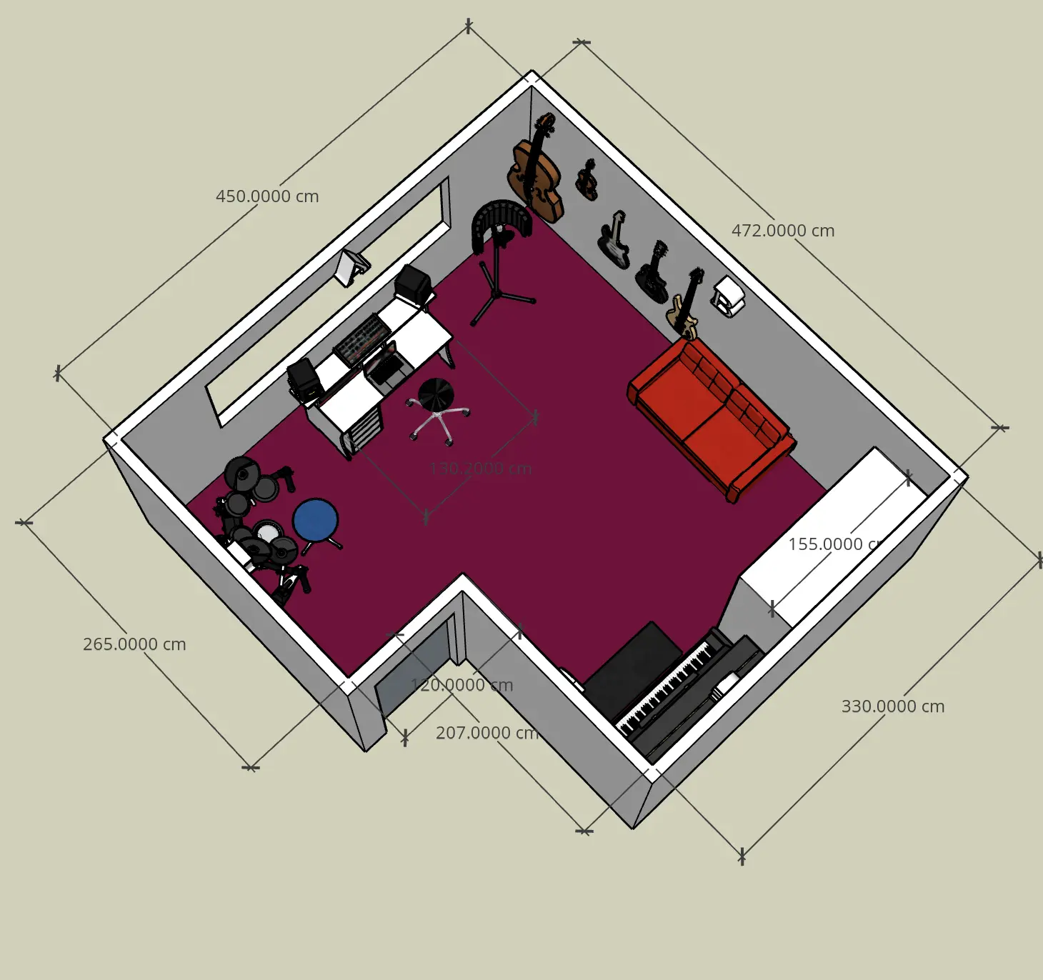

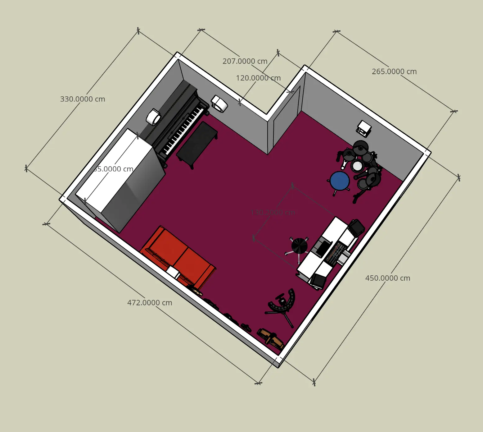

With dimensioned you mean measurements? Sure I’ll do that, and show my latest layout. Thanks for helping out 🙏
Mistadarling
The latest layout with dimensions. Could not move wardrobe, but it's a lot nicer sitting at the window. So far the sound seemed fine when using the monitors, but I do need to reduce some of the room reverb for recording. Mostly ab sorbants on free walls and ceiling, bass traps in the corners where possible. Screenshot 2022-03-19 at 00.40.03.pngScreenshot 2022-03-19 at 00.39.42.png

I think that's a better setup than your previous one. Get some bass trapping in whichever corners you can fit them in, heavy drapes over the window, and see what you get.

Look at that, you repositioned the sofa to get more room angle. Its better use of the furniture.
Get rid of the wardrobe, move the piano in the center of the wall. Put bass traps in the corners.
The wardrobe , is it necessary? The wardrobe is the most asymetric point in the room.

Ok thanks I’ll think about it. It’s not necessary maybe but a good way to keep things tidy and I’ve got a record player and LPs inside, as well as CDs. How about just take away the doors?
