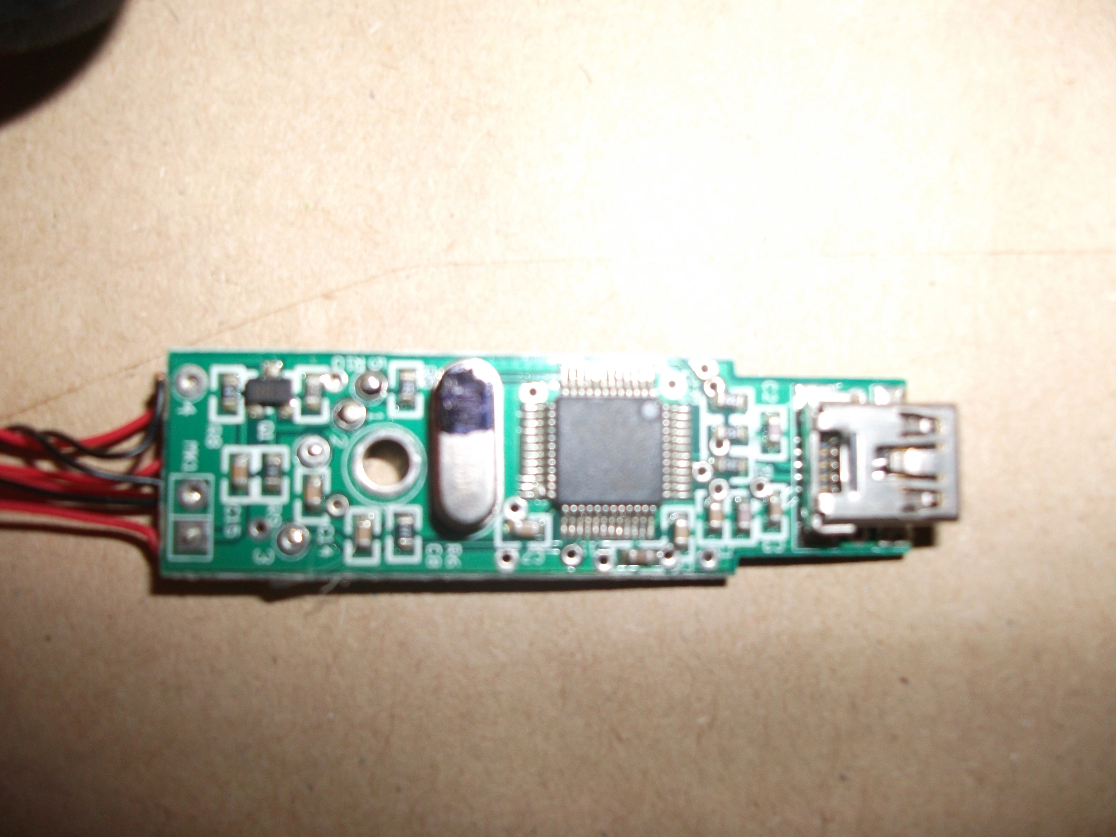

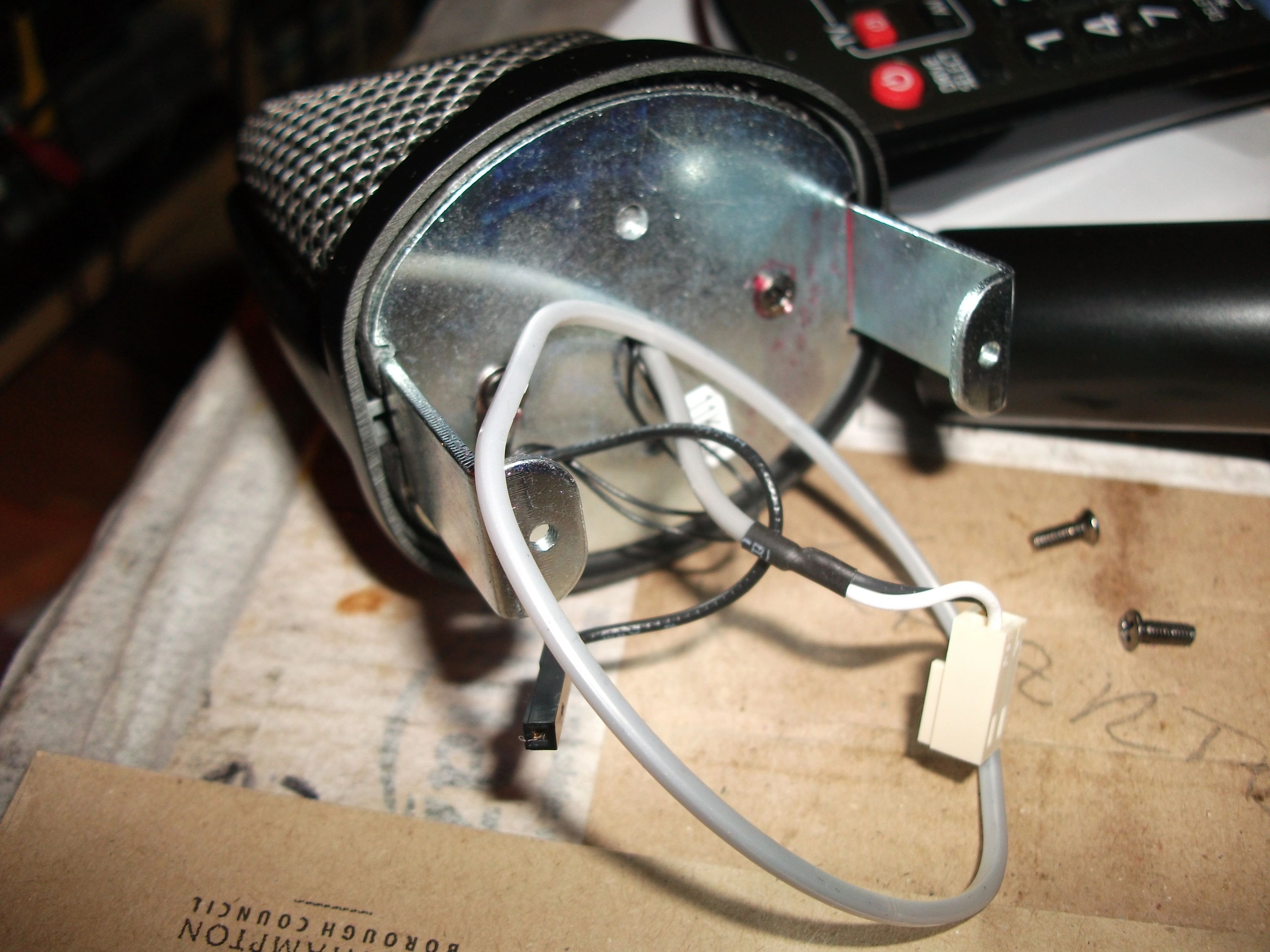

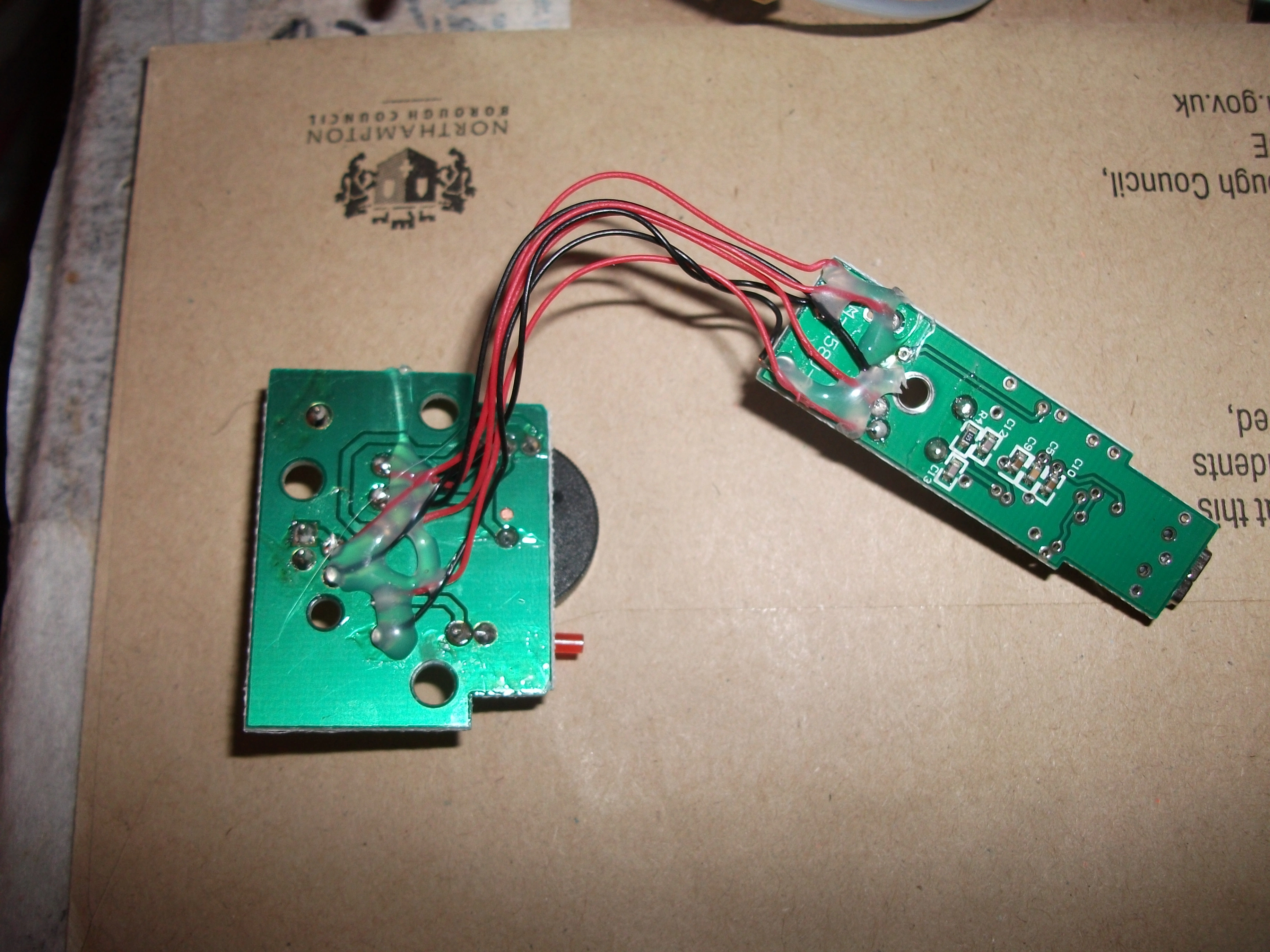

So, I have taken a Pozi #1 to my USB mic.
Sorry the converter board came out badly I am going to Google for the single chip on it.
I did take the plate off the capsule housing but there are just two wires, hot and earth going to the capsule and there is no 48V on the PCB so that must be an electret element.
In contrast there is a lot more stuff inside that AKG including I would bet a DC-DC converter to produce a polarizing voltage and possible more than the 5 USB volts for the impedance converter so as to give better headroom?
Still worked when I put it back together!
