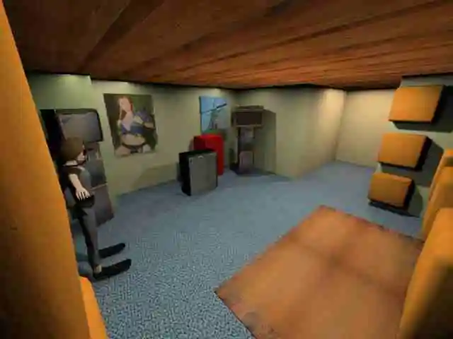

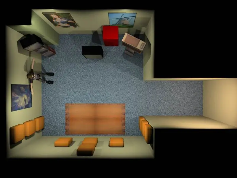

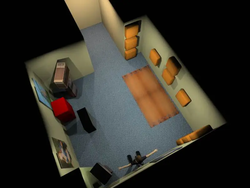

Ok this will be the live room, it does not seem to be until now. There are two doors and one window I didn't picture there, but one of the doors is at the end of the aisle and the other one, at the right hand of the pretty snorkeling girl... ;)
Main problems I get... room too boomy... room too damn warm...anoying highs... I put some egg cartons on the wall behind the guit amps... and carpeted floor...
Well, I hear critics... jjejej... the drums are supposed to be where the foam is...
Byeeeee :) ... and thank you so much...

Whats up? What did u use to make this diagram?
I want to see a better shot of the pretty snorkeling girl!
Studio looks good too. ;)
I used 3D Max 5.1... and the snorkeling girl is not as pretty as you guys think... she is just standing there.... for proportions issues... The amps there are a Fender Deluxe '90 at left, a Bassman 10 in the middle and a Carvin Belair 2x12 at right.
Well, the fact is that it seems to be too much bass frecuencies fooling around and I dont get to lower them... of course, I cannot lower the amp's volume... thats not the idea...
