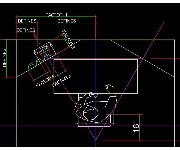

Ok. Just a simple Autocad plan to show what I was saying. Unless someone else jumps in before I do, I'll do it tonight. What are the top dimensions of your monitors, and your console/mixing station?

:D Actually, at this point I don't know what good it will do other than illustrating a monitoring "equalateral triangle", using your speaker dim's as a starting point. You've mentioned your mixing station is going to be mobile, which would make for easy placement. In my case, my mixer/console is EXTREMELY heavy and quite large, and had to be precisely positioned relative to the soffits, to achieve the equalateral triangle I desired, PRIOR to building the soffits. Hence the need for monitor dimensions.
On another note, I've ran across threads from people who had VERY LARGE speaker enclosures, that did NOT allow them to achieve an equalateral triangle relative to the existing dimensions of their room. No matter what I did to illustrate it to them, they "didn't get it". Hence my offer. No matter though, I'll still do it. It may or may not help you, as I'm sure you already have in mind what you are trying to do. Hell, no matter how hard I tried to illustrate the principle to some people, they STILL put their mixing position IN A CORNER!:rolleyes: Oh well, to each his own.:D BTW, here is an illustration to illustrate the EQUALATERAL TRIANGLE FACTORS. Maybe it will help SOMEONE.:p
