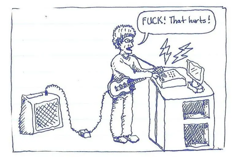

Someone mentioned a picture...there are photos of the room in the "let me see your studio" thread around page 340 something...but it would be hard to capture the actual event on film, so I drew a quick sketch to further illustrate my situation. I hope this helps:
