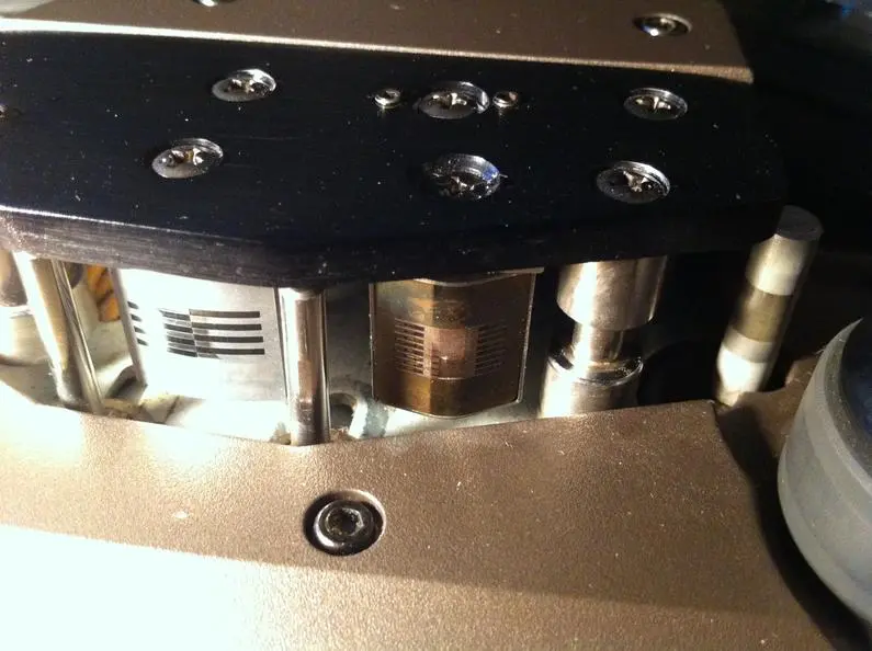

So now I'm wanting to get the expertise of you Tascam 388er's who know the deal with how heads should look before being relapped. There is a slight dark shadow on the erase head otherwise its pristine looking. Not sure about the rec head though. There are some killer places in new jersey who can relap, clean, align and calibrate for a modest price but I'd like your opinions if you don't mind.
Last question: should i rotate the tape lifters if the have a small flatness to them? Is that not as important as rotating the guides when they become slightly worn? Any help would be much appreciated.

Anybody got some advice on the picture???? Heads look ok?
The BEST way to know if heads are good or bad is whether or not it calibrates to spec.
That being said both heads look fine.
The shadowey spot on the erase head looks just like its burnished/polished from tape. No problem. Erase heads typically wear a lot longer than record/play heads. The play head just looks to have nominal wear to my eyes and I suspect it has quite a bit of life in it. You could have it lapped but I don't necessarily see the point if it sounds good and is working right.
You're not going to burn out a motor from it spinning "too fast"...think of it this way...the motor can only go so fast due to the design, and you can be sure it was engineered to go that fast.
If you aren't going to lap the heads don't mess with rotating the guides. The heads are fixed along with the guides (actually the erase head is fully fixed, the rec/play head is semi-fixed, fine-set azimuth being the only adjustment) so the wear pattern sets into the heads and guides and if you rotate the guides now you're going to change how the tape sets in the wear groove. If/when you get it lapped have the entire block done and have it set to the rotated guides.
Don't mess with the lifters. No reason to unless they are causing nasty edge shed issues or something but if they are being kind to the tape then there's nothing to do and no reason to do so. Rotating lifter posts is a mixed bag at best as the posts are punched into place...you try to rotate them and you risk bending/marring the post and/or loosening the joint. I prefer to purchase new lifter assemblies...did this for the 58 I used to have and got a new set for my BR-20T. Dunno if you can still get them for the 388...actually I think you can but I didn't want to spend the money. You can also get surgical tubing. If you can find it this is thin-wall stainless tubing and if you can find material with the right ID you can press-fit it over the existing lifters and create a new bearing surface with this tubing "sleeve".

Rotate the tape lifters yes because the sharp edges are hard on tape. You want the tape path as mirror smooth as you can get it... at least deal with the rough edges where you find them. :)
