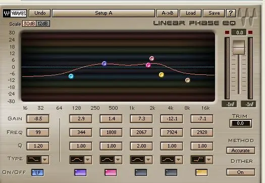

For a first mix it sounds pretty good. The bass is rather muddy, and you have a completely out of control bottom end. The kick and bass are both floppy down low. Also, the cymbals are kinda harsh and distorted. I took and eq'd the mix a bit, and it sounds much better to me, but if you attack it at the mix level you should be able to get it much better.
That is fantastic...care to share some of what you did with the EQ? The Bass sounds so much nicer. You can hear the notes instead of just a dull bass-like thud.
Here is what I did. It could probably be dialed in better, as I spent about 1 minute on it. If you attack the issues at the mixing stage, you could make it WAY better.
