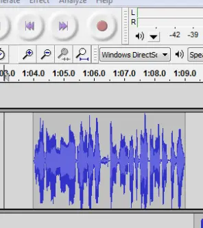

Respectfully have to disagree.... his last image shown tracking with his cheap USB mic is what the levels should look like in Audacity. He's got them up at almost max with no clipping. This is where my levels usually run as well. I still think something amiss, but not sure where in the chain it could be.
I don't think he should be recording with levels that high, in my opinion.
Are we talking about tracking vocals/instruments or transferring from one medium to another? (ex. From vinyl to computer)

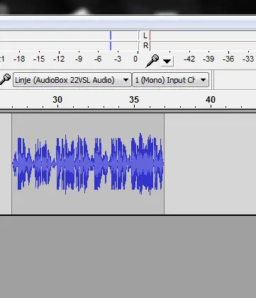

I've been doing it pretty much per the Audacity manual, keeping the levels as hot as possible just below the clipping point.
That's obsolete procedure from the 70s that continues to infect various equipment and software manuals. Peaks should be well below 0dBFS, around -12 to -6dBFS depending on the dynamic nature of the audio, with average levels around -18dBFS or so. Converters are generally calibrated to 0dBVU is -18dBFS
Even before I saw the picture of the beats I was going to say turn the beats down so they peak around -12dBFS and turn the headphones up. That's still my recommendation.
Fair enough man. Maybe you're right.
I said to find a happy medium because his last clip sounded too hot.
Maybe that was just mic technique and air blasts though. I'm not sure.

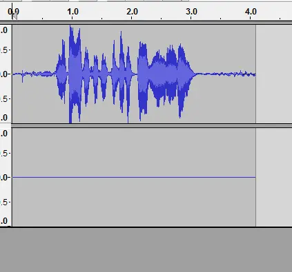

When I change to a stereo track, and record there's nothing wrong, the sound gain level is great, but its only recording it in the LEFT track..
Idk why :/

Worst case scenario then, you could always go over to the left of the track and choose to "split to mono". Then duplicate that track, and pan 1 hard right, and the other hard left, and make the second track a split second after the first. That'll make it a stereo track.
Also make sure you are singing/rapping into the "front" side of the microphone, not the back.
Idk why :/
something went wrong, dont mind the other Pictures.
Not Shure which 'pics are for which example, but with the cards I've seen the input options are always for each stereo pair, and there's a set of three- 'L and 'R monos and a stereo. For your top attachment- a stereo track, obviously you'd have to split your mic or what ever to feed both inputs of the pair to record to both sides -and using a stereo pair for a mono track sort of a waste of course.

I suggest that there is something very wrong with his set-up and the suggestion by Arcaxis is quite possible as there are two things that I have observed from the initial photos that Markel posted, these being:
1 In the photos of his fader positions, I notice that every fader is fully up (the ideal position being about 75% the way up), but even at full fader the Vu meter readings are quite low. This suggests that there is either not enough signal from the microphone to drive the mic-preamp unit correctly, or that the mic-preamp does not have enough internal gain for the microphone.
2. In the photos of the various recordings he did into Audacity, the first 3 (I think there were four takes) are way too low in level, the last one being a far better level (but even it is a bit low). HOWEVER, if you look closely at the wave in the last take, you will see that it is nowhere near peeking within Audacity, BUT the tops/bottoms of the waves are completely Square Waved (ie completely distorted), hence the sound he is complaining about.
The Square Waving in Audacity, when it is not overloading the signal being recorded by the Audacity program can in my opinion ONLY be caused by the signal leaving the mic-preamp being distorted before it leaves the mic-preamp.
Again I state that I do not know the mic-preamp he is using, but I will bet my 40+years as a professional recording engineer, that his problem lies within the "gain structure" that he has set-up. Whether this be caused by the USB circuitry somewhere drawing too much current from the computer, the mic-preamp not receiving enough voltage/current from the USB cable and thus causing the electronics within the mic-preamp to be struggling, the settings of the gain structure within the mic-preamp being wrong (is he possibly using some form of line input rather than a mic input --- could explain the high fader position and low Vu reading), are the audio mixer settings on his computer's sound card set completely wrong, etc, etc, etc.
Whatever the problem, I would definitely say that it is "gain structure" related somewhere between his mic and the input to Audacity and from my experience, the understanding/setting of this, is the main problem most people have in getting a good/correct sound, especially if they are new to the industry.
