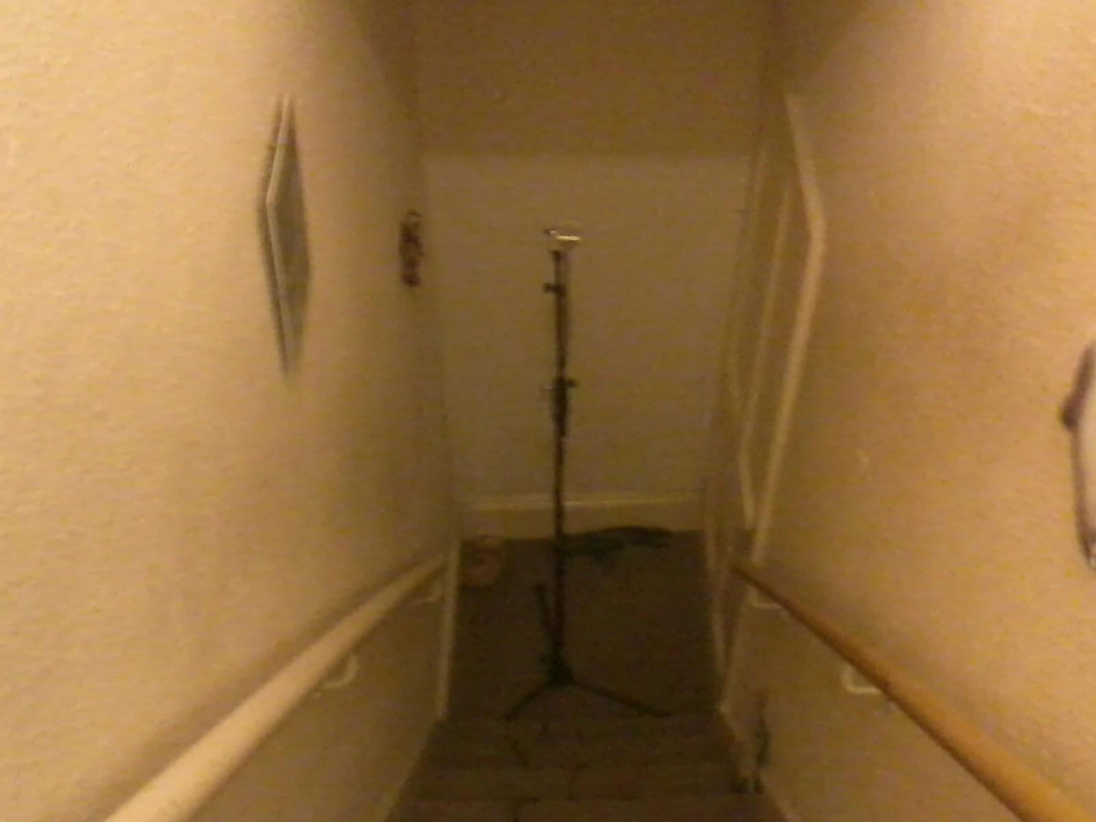

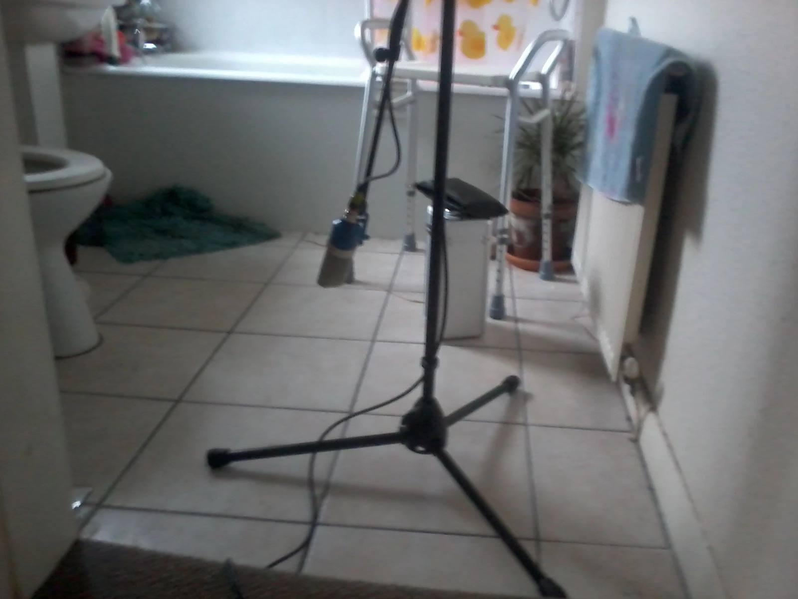

Tbf, after playing around in the hallway i started venturing around the house to see how different rooms sounded. Long story short - hallway/top of stairs (old 1920's red brick terrace with a huge space above the stairs) great for "percussive" percussion (claps, blocks, tambourine), and bathroom great for "jangly" percussion (jingle bells, shakey egg, maracas). Tbh i will probably still do the majority of recording in my music room as everything bar the handclaps sound absolutely fine in there, and i'd much prefer to have a dry, controlled sound i can edit/work with than having to work around an already wet sound, but for somethings the space is exactly what it needs to make it "pop" as it were.

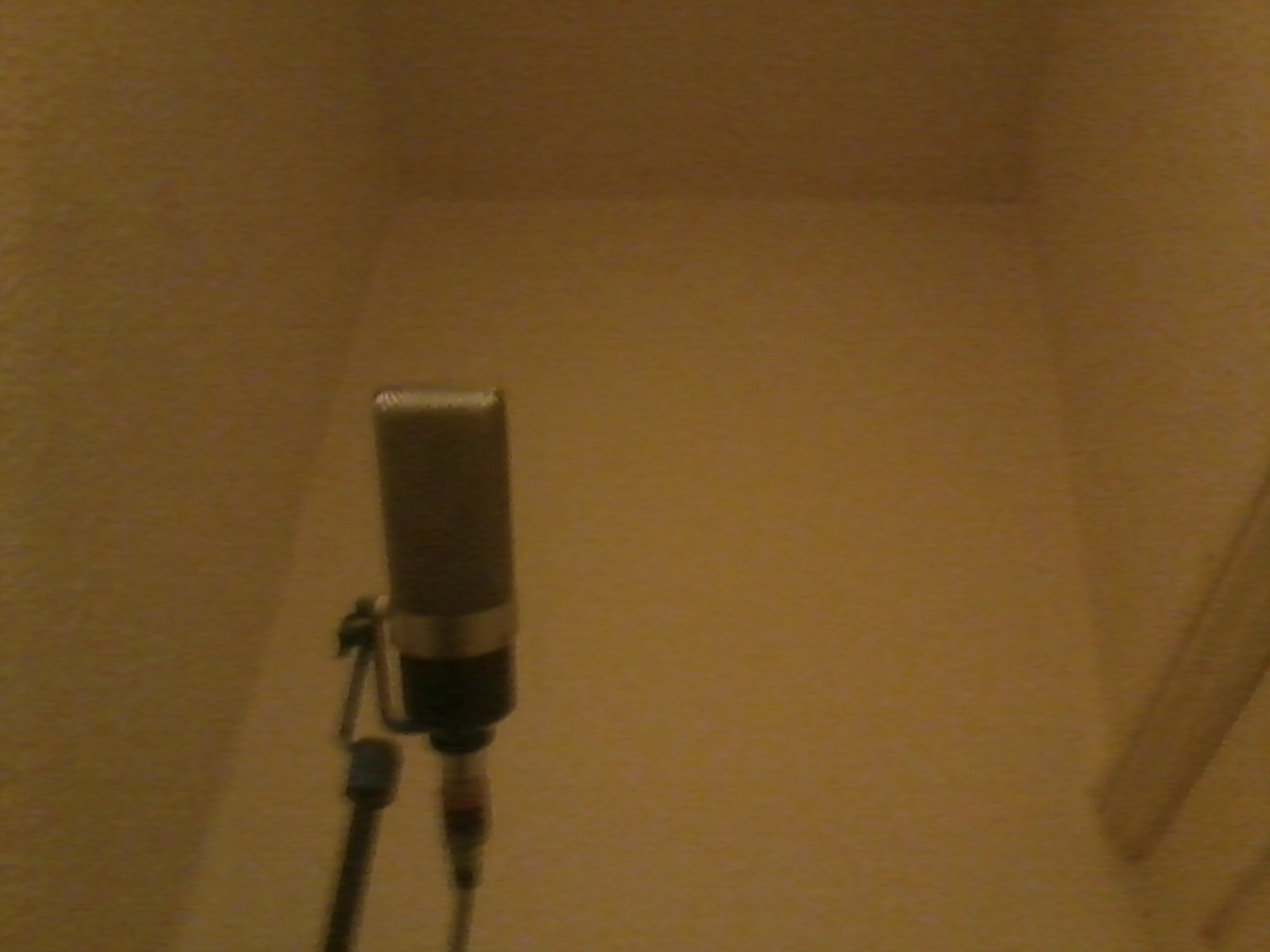

Do you know what's really annoying; over the past week i've been taking a lot of photos of mic placements and pedal settings as i'm working on an album for the same band and want to be able to recreate a sound if needs be, but looking through my phone i have only have a couple of photos, and both are from reamping drums to get a create a room mic/real reverb from, but you get the idea ;)
I tried to add them to the post but they're too big so rather than resize them i've just done them as attachments.
EDIT: yay, they kindly resized themselves. Thankyou internet/HR :)

Thanks justsomeguy that looks like a nice place to mic up things and not to mention a real nice looking and probably sounding mic...Neauman??(wrong spelling)
Cheers man. Yeah it's a fun old house. Plus the neighbours on one side is a mate of ours who plays drums and has band practices at his house so neither of us minds the odd bit of musical noise, and the other neighbour is cool and assures me he doesn't ever hear any thing.
Ahh man, i wish it was a neumann. It's a £60 Alctron HRM8b ribbon (essentially Apex 205 before being rebranded) with the internal blast filter taken out. It sounds awesome but, for distant micing it needs ALOT of gain and it can get noisy.

Still I bet the mic has a lot of character/quality and sentimental value to you for sure!!! :listeningmusic:

gotta respect that, especially the bathroom photo. many other would just put some convolution there and pretend it's fine. im planning to do something similar for the album where drum rooms are unusable, maybe this photo gave me faith. thank you.

Tbh it's the first ribbon mic i ever bought and the first mic i ever modded so it's very high on the sentimental value list. Plus, it does sound fan-flippin-tastic. Really deep and tight low end and ultra smooth high end. It's not great for everything, but it's one of those mics that when it's right, it's absolutely perfect! I used it stock for about a year and loved the sound but had always planned on modding it as there's so many detailed online articles about how to do it, but because it was my first time doing anything like this i decided to do the simplest mod that i could reverse if i didn't like it. I roped in a mate who's better at this kind of thing in to give me a hand (and by that i mean he was mainly there to offer suggestions/advice/troubleshoot/not panic if i did) and after a very scary 30 mins of working around a very delicate ribbon we gave it a go and the result was awesome. If you've not got a ribbon mic in your collection, the Apex 205 is a really nice first step into the world of ribbons :)

Cheers man :) Tbf i use Altiverb for all my main reverbs and probably 90% of the time it's fine (and if altiverb isn't working i use my old Alesis Microverb I. Sometimes less choice just makes things easier) but i really wanted that overly smashed room mic sound and found that compressing convolution reverbs didn't have the same vibe as a "real" room mic so i took an old school approach of playing the drums back through a speaker into my bathroom and recording the results. I EQ'd and compressed on the way in mainly so i could get the exact sound i wanted at source (and i love the way the FMR RNC pumps when you push it). The bathroom works really well for a nice gritty, "spitty" drum room sound and the bottom of the stairs is just a bit softer sounding.
