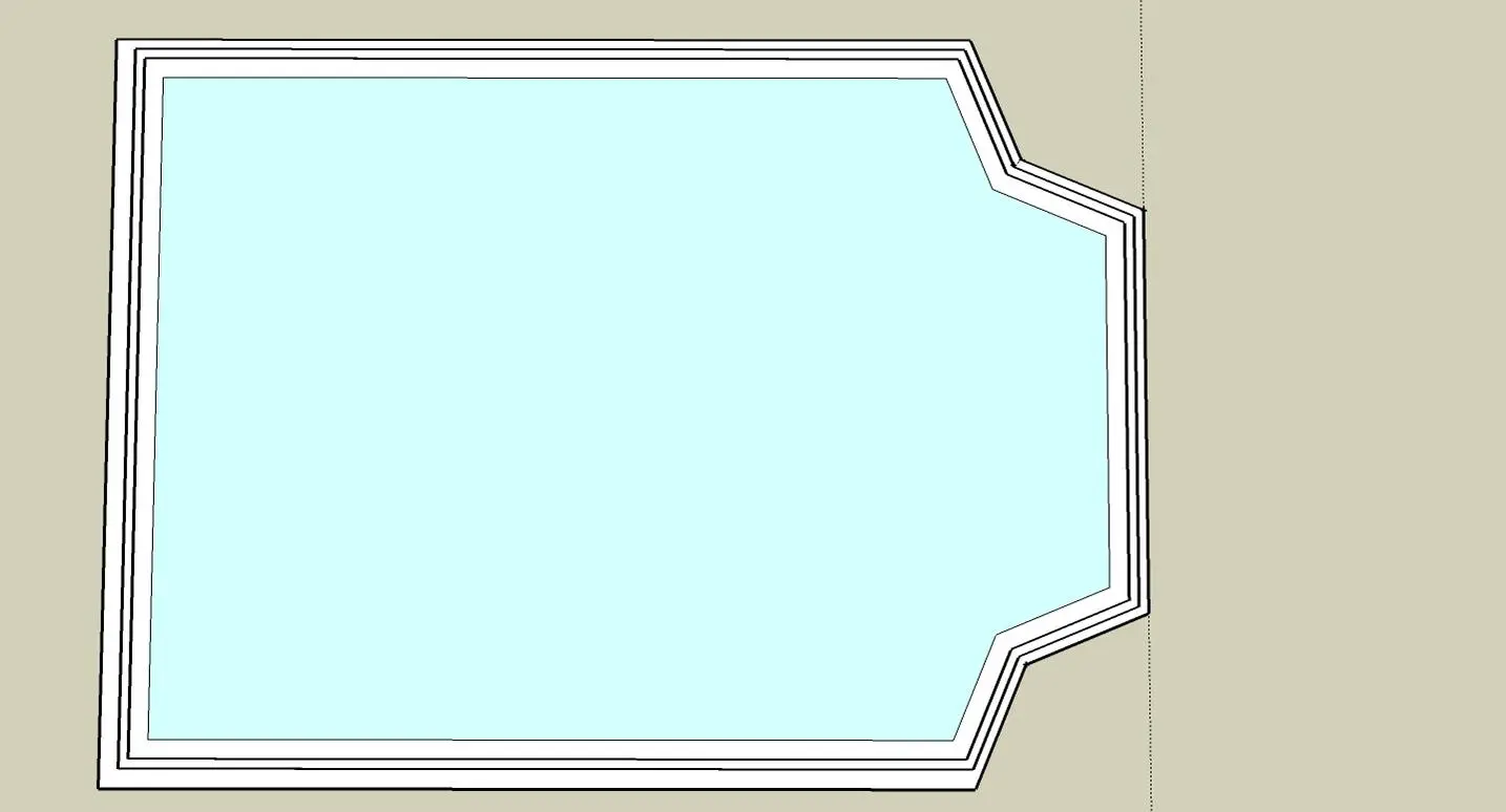

here is a picture of my initial sketch.
the widest spots are 11'6" on the inside
and the longest is 16"6"
How does this seem for the initial plan?
2 walls are cinderblocks.. so, i intended to offset the
2x4 studs, by approx 4 inches. for air space.
the other walls will be double studs, and have 2 layers
of sheet rock, 5/8ths..
on the right track?

Is the odd shape on the right of the drawing the natural shape of the foundation or have you planned to build it this way for a different reason? How deep is that recess?
Bryan
if you are viewing it so that the recessed area is on the right of the screen.
the bottom cut out is where the Hot Water Heater is placed. I don't want to move it
and want to leave adequate room around it for any servicing. and air flow.
the top cut out, is to keep the room symmetrical for mixing purposes.
the recessed area is 3 ft total depth, but it kinda slopes so it's a varying depth.
If you can kill the ceiling in that area and use some panels on stands pulled across the face of it in an arc, that'd likely work fine and allow you to do mixing at the other end.
Bryan
there are some pipes up there that i'm going to avoid, so
the ceiling will be pitched a bit, to accomodate them.
and it will avoid me having another 90degree angle in the room.
