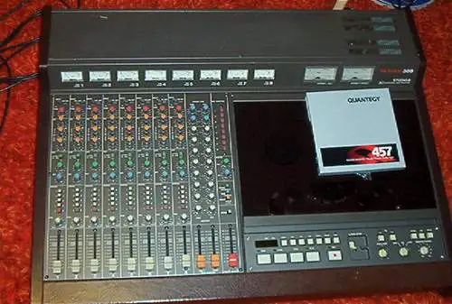

Well I made the trip to chicago today to deltronics and picked up my 388. The whole trip only took 7.5 hours after i had to make a detour so we could eat at my wifes favorite restuarant.
Took this bad boy down to the studio and fired it up all looks good all works well except all meter light,s are out checked the connection for those and the fuses but no cigar.
The unit works great other than that so I guess i will have to live with no lights on the meters.

The tech and I checked the bulbs out while I was there picking it up and it appears all of the bulbs are shot. Im guessing when the power supply went it took the bulbs with it.

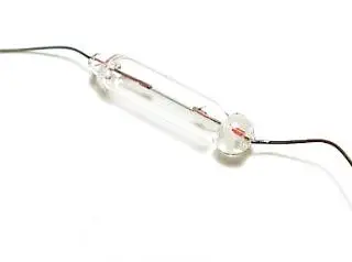

Well, I have a link to that type of bulb, if you're interested, but they're solder-in-jobbies. You'd have to gain full access to the VU meters, and split each one, removing the plastic cover from the face. It's another labor intensive job, for which the parts are only about $10. It's tech-labor time that you really pay high dollar for.

I'm not sure what voltage they are in the picture, but it's the closest thing I could find to the Tascam bulb. It's listed in the catalog as "Panasonic bulb", so go figure.
Electronix dot com sells the bulbs for $1.25/ea., and Tascam sells the bulbs for $8~$9/ea., so if you can find the above bulb in 8V at Electronix dot com, then that's your best deal.
I believe the Tascam VU meter bulb is rated an 8V bulb, solder-in little dudes.;)
