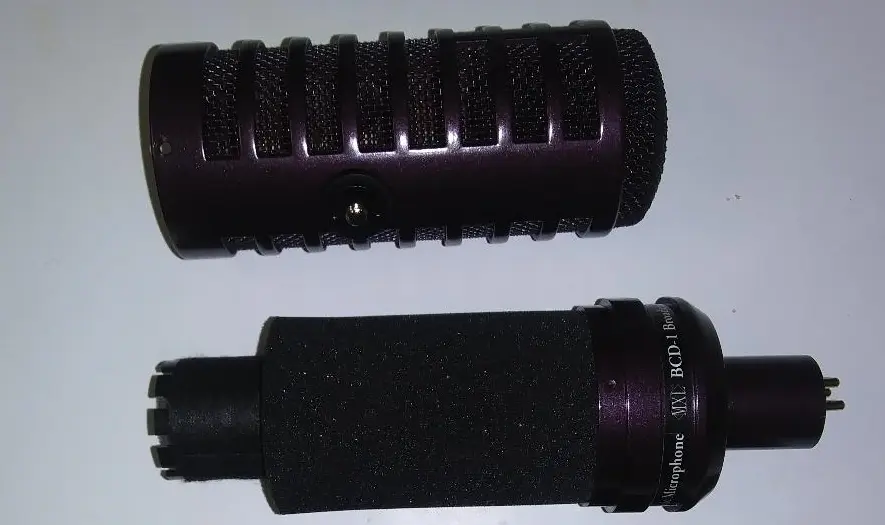

1)My fav site of mics is Recording Hacks but for the first time they didn't have much. Matter of fact they even had wrong info on this mic. Theres no HPF, let alone three of them?:confused:
2)Many places also call BCD1 a LARGE Diaphragm mic, unable to find pics, the BCD-1 was taken apart.
Results its NOT a LARGE D, its the same as a Shure SM7b....same as a SM57 same as a SM58...:rolleyes:
3)Even MXL's manual paper says MUST USE PHANTOM POWER WITH THIS MIC...?? :wtf:
Its a dynamic and no Phantom is needed.
4) another review mentions it doesn't come with the standard mic stand adapter but it does, you just have to unscrew it and the insert comes out for the larger mic stand thread adapter.

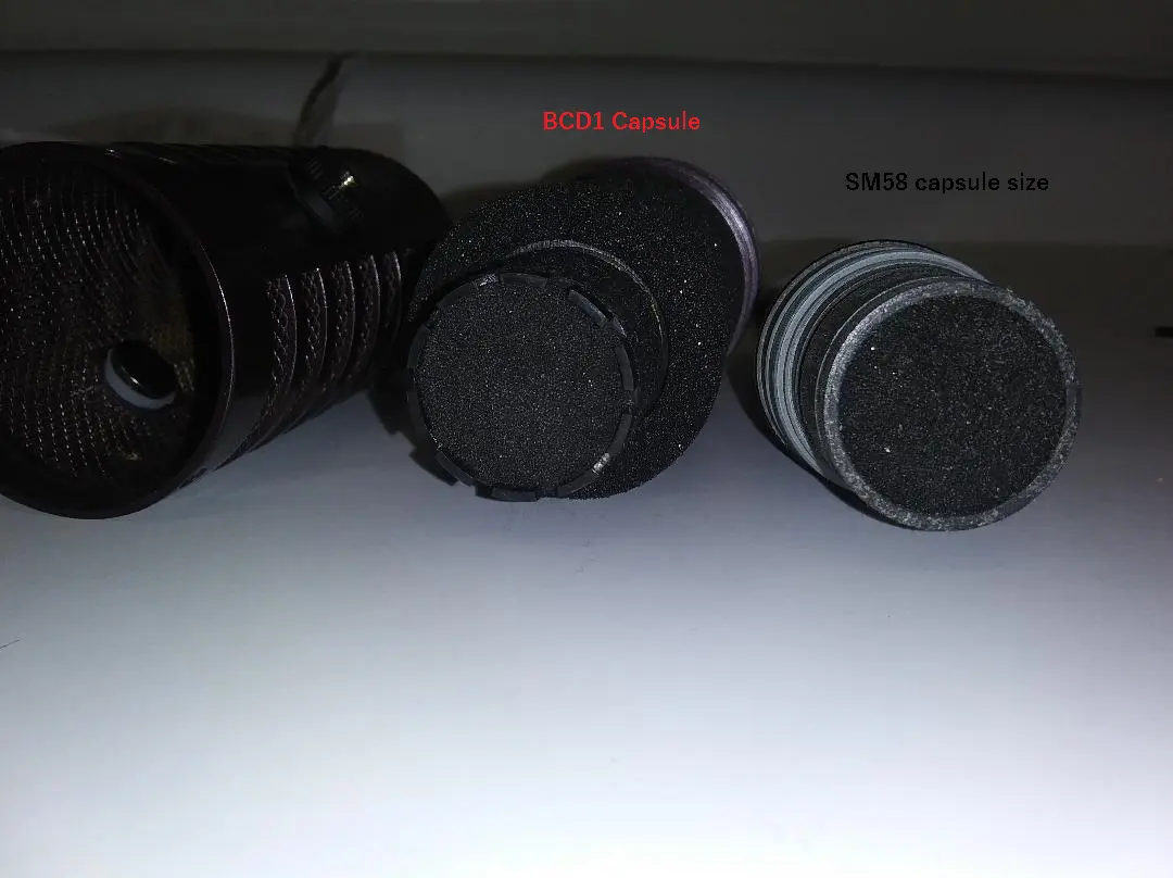

Looking at the picture the capsule is at the "2nd ring" from the end.
Its smaller than the SM7b and in my small area thats a plus.

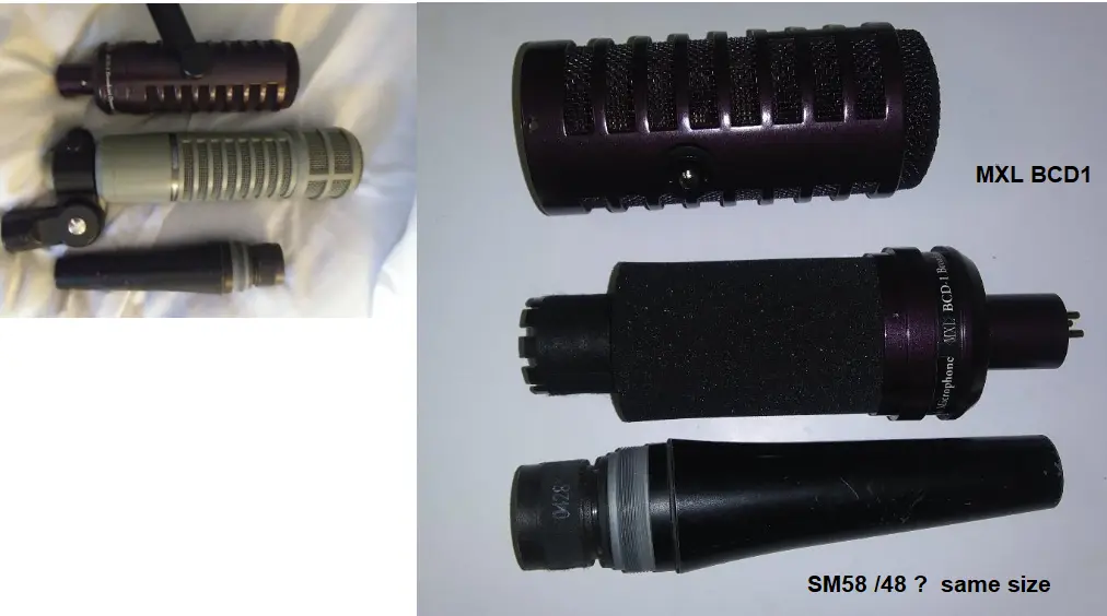

<add> just grabbed a RE20 to see what its like , compared to this MXL- BCD1 copy

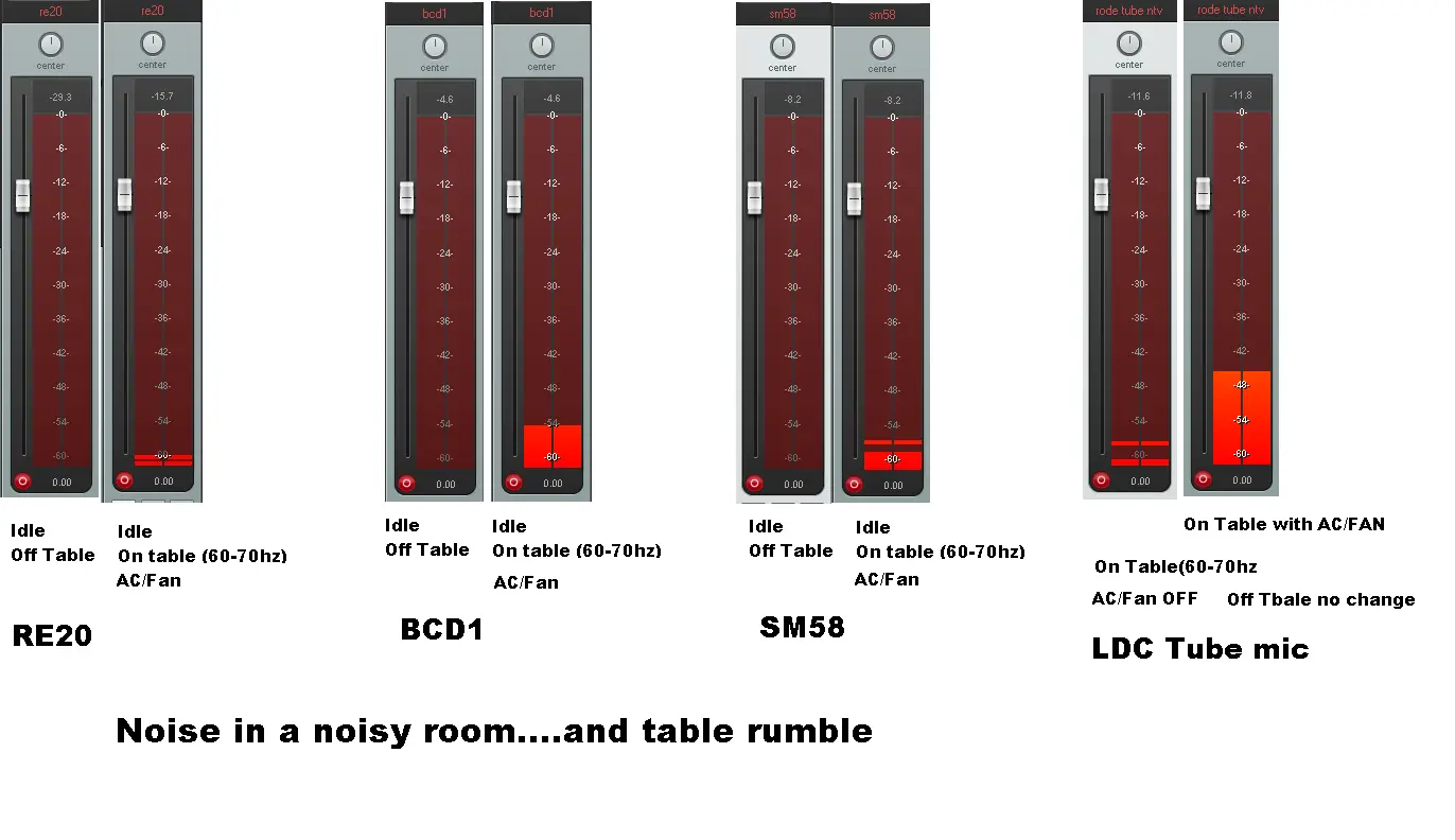

Ill add this note of the test picture to better explain the Noise difference.
The mics are in same position and same gain per the Reaper meter.
The noise is a Window AC about 18ft away and a floor fan about 12ft away. The PC fan is about 2ft away.
The main interest I had was the room noise, but I also found with a nice preamp and a bit of 10K this BCD1 mic sounds very nice too.
I think I learned something too, I was mistakenly thinking of sensitivity as this huge difference, but now I think its the Pattern more so than sensitivity rating. The huge drop off proximity and side rejection and rear rejection, where as sensitivity could show the same noise floor once the volume is adjusted.
Anyway! fun stuff...

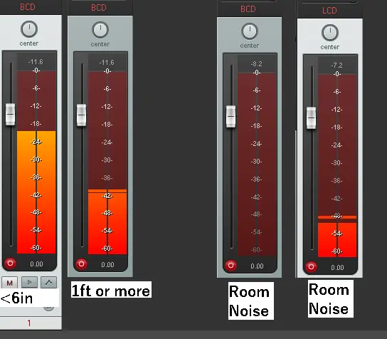

continuing this review....its amazing how the engineers can design stuff like this BCD1 and noisy room rejection pattern.
I think the BCD1 might even be more drastic than the SM7b in rejecting the room as in sound drops off really fast as you move away from it.
I got out the measuring tape and it was only 3"!!! away and the sound dropped off in a huge way.
While this is interesting as a science project and design test.....this mic would be horrific for someone who moves around or cant keep their mouth on the foam.
bizarre … unforgiving for a moving mouth/head...but a wonder for a noise rejection in a crap room, ambient...
I didn't notice any major overloading of the mic but the preamp gain needs attention to not overload the interface...but this isn't a problem.
For me Im not a screamer, and staying on the mic is easy in a desktop small space deal...and keeping the mouth on the foam, is same I did with the SM7b for consistent tracking, but more attention is needed to that.
RE20 should be here today, that will be interesting to compare. The RE20 is a true large diaphragm , so BCD1 is probably a mix of re20 design and smaller SM7b type capsule. Already I think I like the smaller size of this BCD1 better, RE20 is pretty large , very large Im reading.

RE20 showed up and snapped a side by side, the RE20 wasn't as huge as some said...like "DANG!! THAT MIC IS HUGE!" was a concern...:eek:
But it was fine and larger than the BCD1 but not scary Blimp size....that was a good thing.
Ive wanted to try a RE20 for a long time, it was a decision between it and SM7b , so now its here years later.
First thing was the droop on the standard mic holder, I guess I can try tightening this but its brand new. It came with a shock mount, but Ive read that's huge too. The internal shock mount was the best of my tests as far Table Rumble...on and off the table, in this room, a Boom Arm will be installed.
SM58 was included today too...
ok...room noise test comparison...Noisy room....AC window, fan on floor, pc 2ft away.... table rumble 70hz and below...
the BCD1 did great.
the RE20 maybe even better because of internal design.
the SM58 did ok, but handling and didn't have the mouth on the foam, ease of a broadcaster mic
the LDC has worst room pickup but most tolerant of someone moving about singing..etc..
as for my ears on sound, I don't know, the dynamics sounded similar, the BCD1 had more top end...I don't know yet. I'll need a few months to feel the vibe of each. def to get a boom arm stand and remove the rumble! the HPF filtering takes out the rumble too, per my LA610 eq at 70 and -6 or -9.... still I like the boom arm thing.
this review was interesting, the noisy room revisited, I got to say I like the MXL BCD1. :listeningmusic:

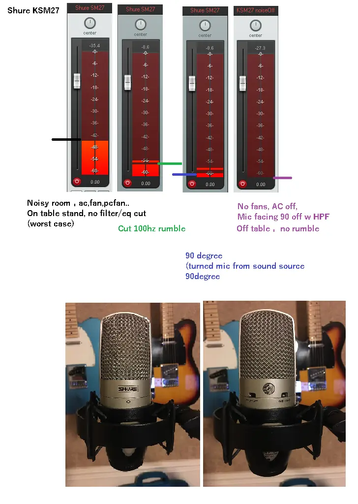

Surprise was, and I think my favorite of all, in the happy-medium level is the KSM27. (AKG 2000B too). KSM27 cheap, $80-$180.. with 2qty holders included. It has the LDC sparkle but a tighter pattern for noise rejection than most LDC, a comfortable mid sensitivitygain, but not too much for a crap HR room, and a effective HPF. I recall it being used live even so noise pattern makes sense the aka DIXIE CHIC mic, its built and drop tested like SHURES heavy and steel..nice solid feel. etc..etc.. The other AKG 2000B was dusted off and very similar to the KSM27. $80 - $150 used with holders...and MUST USE FOAM, as the SOS article says. lol
