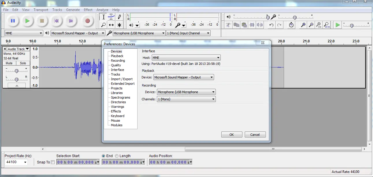

How does the Nady show up in your Audacity dropdown selection, as a Nady device, mic, or something else? My Tascam interface shows up as shown below
Here is mine, Arc.
I pulled my 990 from the closet, connected it to the Nady, plugged in the USB (heard the USB connection ding, no driver load nor Add Hardware), checked to see it in the recording properties, disabled the inboard mic, opened Audacity, added a bit of mic gain, and hit record. I think he is having a port conflict, because in post #9 he showed a USB composite device and post #14 shows a USB Hub.
