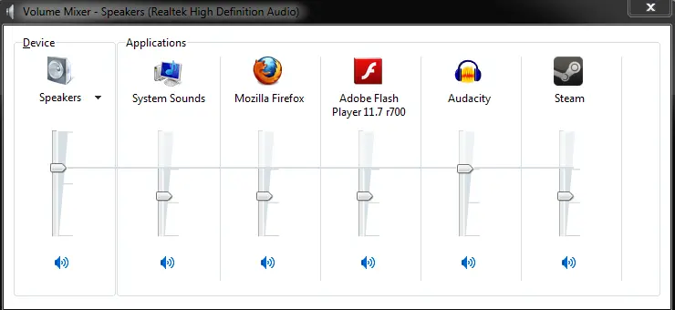

Volume control panel have any sliders down or inputs muted. Possibly that interface may not use a mic input. Then again I'm not sure it would go there or not.This is WinXP.
This is the most its giving me as far as sliders go.
@steenamaroo
I tried that and got no spike

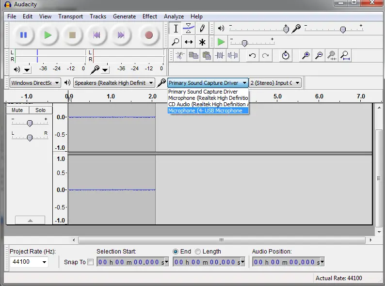

The USB mic is selected in audacity

None of these mic options seem to work and I have been going under the assumption that the Microphone (4-USB Microphone) is the one representing my MXL
