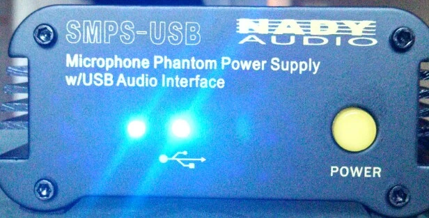

I cannot remember how it was listed in Audacity. I used to connect it to an XP platform. The Nady is purely a 48v phantom power box, with no adjustable pre-amp gain. I used to connect my mics via XLR in, and USB out to the laptop. XP would see it as an USB microphone, running on the USB drivers. The Nady did not have any specified drivers (PNP) and ran through the XP sound drivers, like a headset.

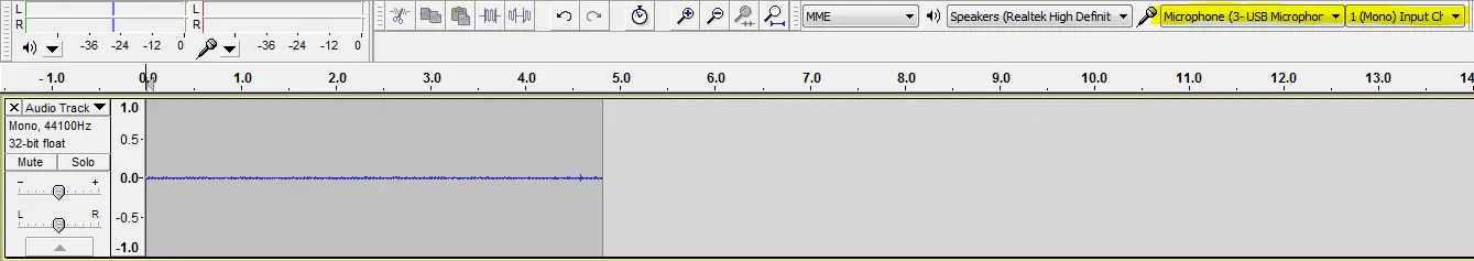

I have loaded Audacity on my new W7 laptop and will go grab my Nady from the booth, when it quits raining in a bit, to let you know.
