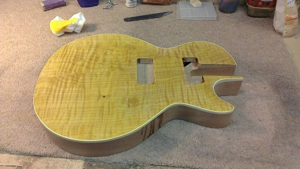

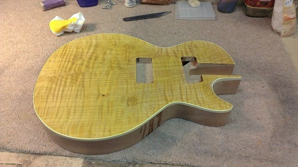

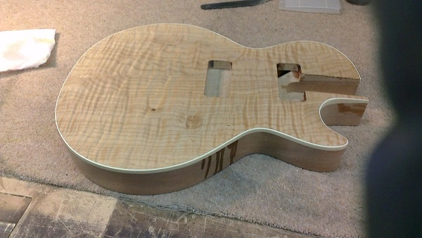

OK, here goes...
First wash the whole thing with spirit...

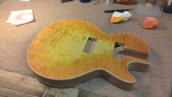

Hit it with a yellow all over

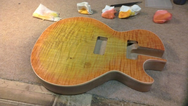

Rub in the Amber and red around the edge and work it in to the yellow keeping the spirit wet at all times.

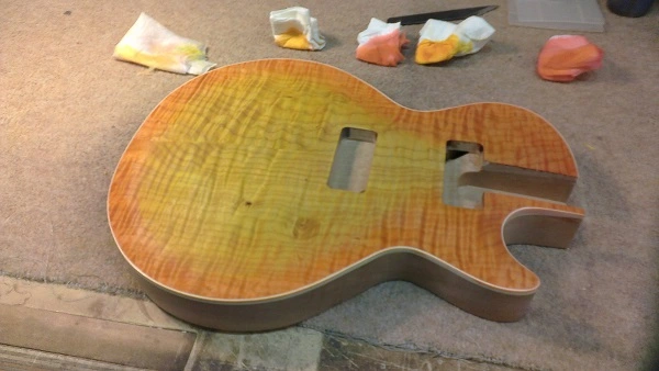

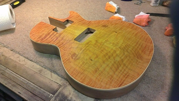

Start to work in more amber and red.

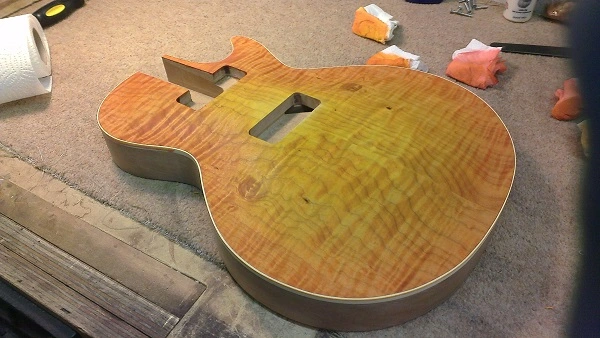

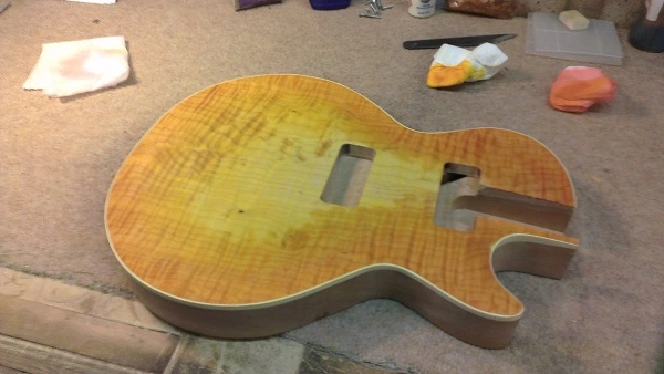

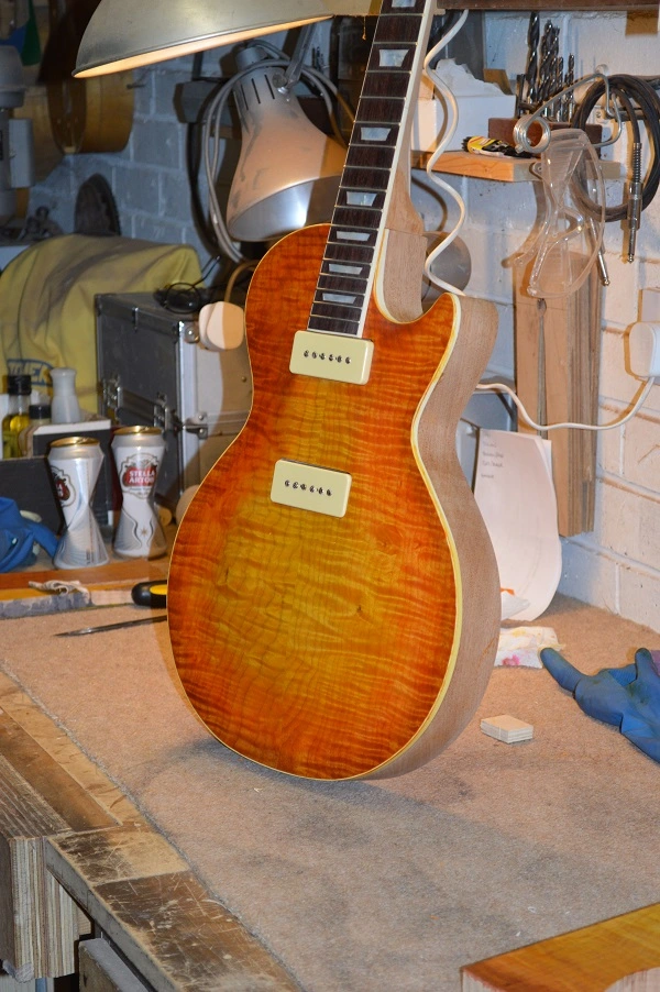

Always rubbing with clean spirit and colour I'm tinkering to get a nice honey colour and finally add a touch of dark amber to the very edge and work it in.
The pictures don't really do it justice as the colours are a bit off and the transition is not as stark but I'm going to stop there and use shellac in the morning to drag it in a bit and finally hit a very fine tobacco edge as a final touch. All in all it's going to plan so far... The new spirit stains are good to work and I'll definitely use them again if the colours hold. More later..

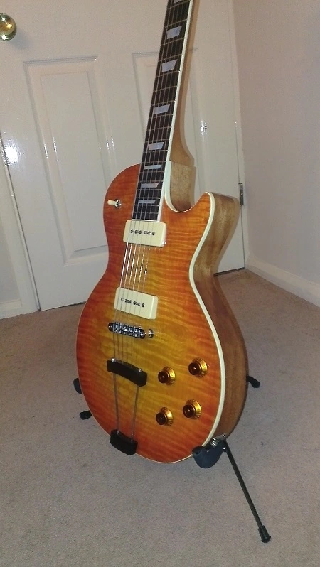

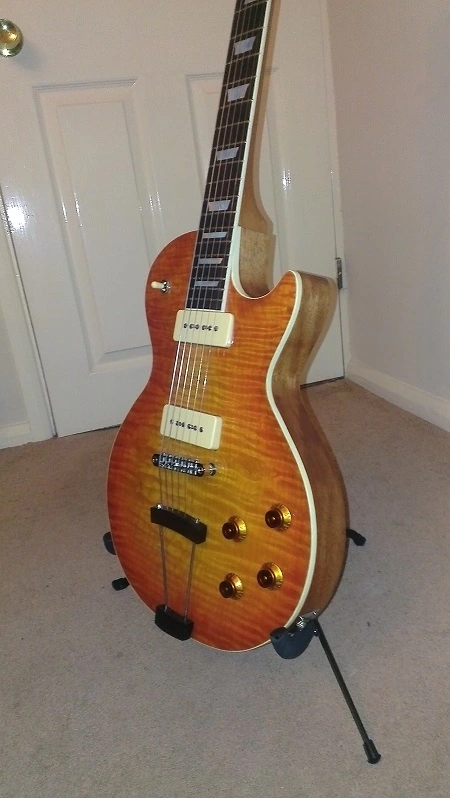

Ended up lending this to a mate who wanted a decent lp style guitar for a tour he was embarking on 6 months later I got it back and he wants me to set it up and sell it on to him... He is gonna do some recording with it so hopefully I can post a few clips down the line. Guess I shall have to make another.
Anyway, I did the set up and sent it off for a few pics here's one that came out all right.

Holy hell, man, that looks gorgeous. Looks like the colors have deepend over time, as well, or is that just the better camera?
I guess the mahogany has darkened quite a bit but thats to be expected. The sunburst in that pic is pretty representative of what it is now. Without looking back over the pics during construction I cant really say if it has changed markedly. I do recall not being entirely convinced that the camera phone I used did the colours justice originally though... I think I said as much at the time but maybe not.
Hey Drew, I've just skimmed through the pics that were done and tried to eyeball which is closet to the "actual" burst. I'm guessing this will depend on our monitor calibration and all that shit but this one is about the closest I can pin down to what it looks like to me and I do have a fairly good eye for colour but I'm not a video calibration expert so ymmv. The mahogany is pretty close to the original pic above...
Yeh, Brazilian and Honduran mahogany more than most will get pretty dark in a relatively short space of time. Often weeks and months rather than years. The fresh worked stuff is nice but it's always richer when it has shaded down a few steps. Decent mahogany that does that is becoming harder to find or more correctly more expensive. Luckily I have quite a bit kicking about and buy it up when I come across it. Lots of the stuff sold these days as instrument grade ends up pinkish and I'm not a fan of that aesthetically but thats just me.
