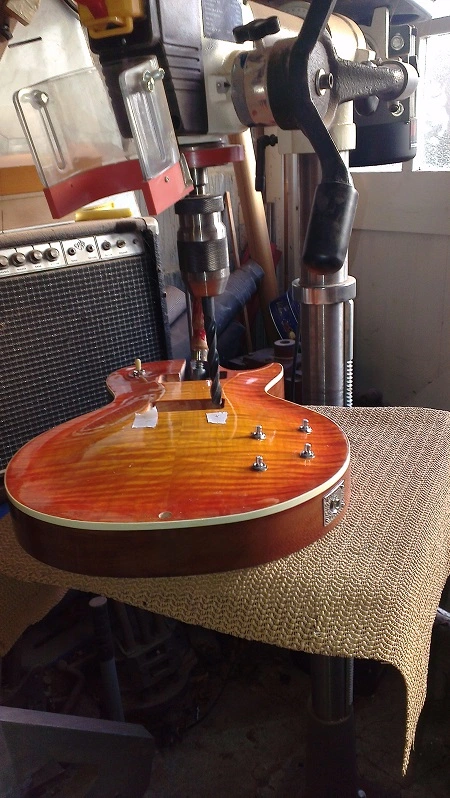

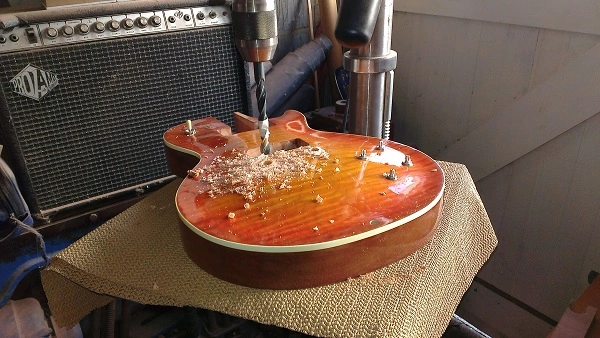

Here she is getting the post holes cut. So close to finished... has about 50 hours work on her so far...;)
Mutt, do you usually drill into a finished body like that? Most guitar builds I see from people have all the cutting and drilling finished before they apply paint or stain. Color is the very last step before final assembly. I'm not questioning your luthierness, I'm just wondering.
When I was building hot rods and restoring classics, we tried like hell to always do paint last. The last thing you wanna do is drop a wrench onto a $25,000 paint job.
I was wondering the same thing. I would be afraid the finish would chip. However I have mostly delt with laquer which is very brittle when completely dried.
I have done both ways. As far as chipping the finish, not a problem if you ahve a sharp tool, the right speed on the chuck and I use a masking tape backer which hold everything in place. You can just about make it out on the pic. I also use a brad point which centers the bit and cuts from out to in rather than in to out with a standard bit.
Things I like about doing it this way...
The finish is completed the cut results in a really clean edge. If you finish around a hole you always get some "dubbing" or rounding of the edge.
The neck when it goes on will have a really clean join at the side of the fingerboard. Finish tends to puddle in there if you do it post joining.
Things I don't like about doing it this way....
Like you said I have to be extra careful about not damaging a nearly completed finish ( I still ahve to give the final buff).
I am now committed to the bridge position. I have no wiggle room when fitting the neck but I'm comfortable with that.
In this case I finished first primarily because the sunburst is done without the neck on for obvious reasons and it needs something on it to protect it as raw stain will rub out and dirty up with handling..
I'm happy doing it either way though after years and years I have still to seriously "ding" a finish on the bench. Touch wood...:D

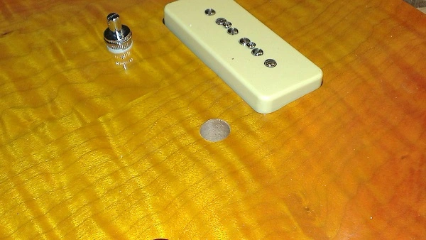

Just snapped a pic of the post hole after drilling. As you can see, a nice clean edge.
The paper you can see round the post on the upper hole is there as a snug fit and also stops the post from biting into the wood until I send it home. It also stop the wood breaking out if I want to remove the post before setting it home permanently. Just little tips you learn over the years.
Yup, that's clean. Your reasoning seems valid to me. I'm just a klutz and things like that give me the heebie-jeebies. :D
I really like how tight and clean that P-90 sits in there.

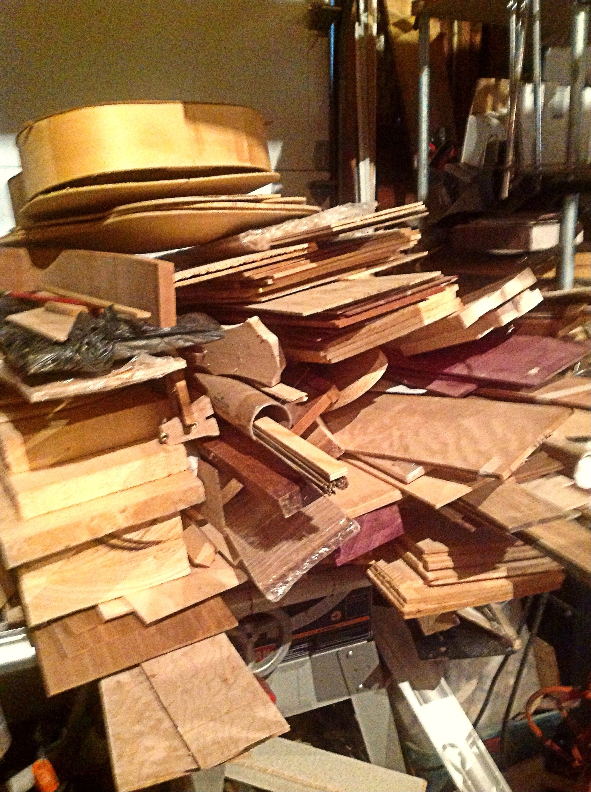

Actually, thanks both. This load was being moved to my new shelving system and had to stack it somewhere. My next build was going to be a Benedetto styled archtop. The billets are there. So many guitars to build and I have never done a solid body electric! Most of this stuff has been in my shop for 8-9 years just sitting.
