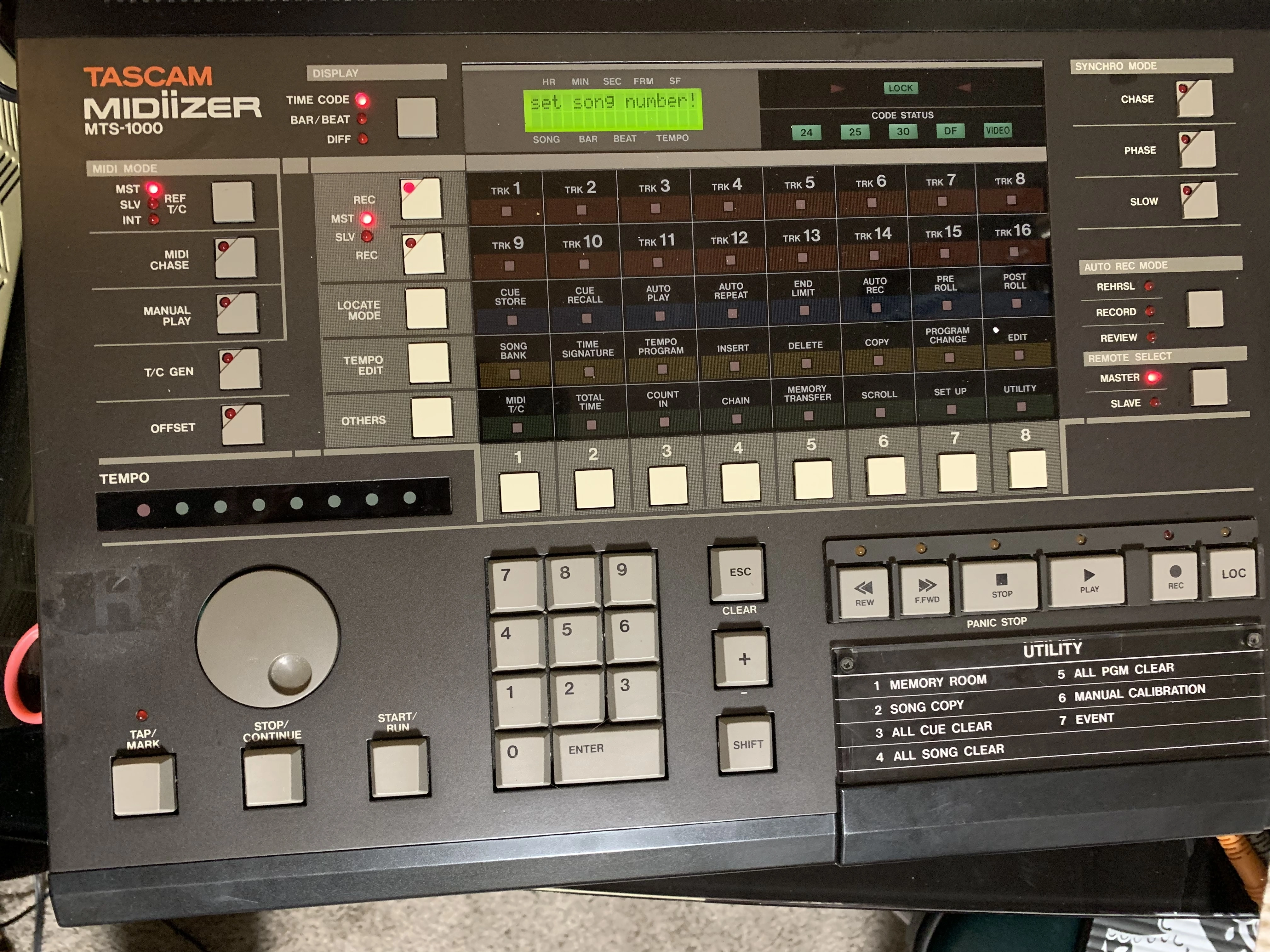

Managed to work a deal out for the TSR-8! Got a bit of a road til I use it for my intended purpose.. basically 688 synced up with it with the midi-izer communicating between the two!
My 688 needs some service too. Most likely won’t have this rig set up for a few months. But I got a 488 Mkii and a tascam 32-2 to keep me busy til then.
Very exciting stuff tho :-)

You bring the 688 over to where the 8 track is? I’m not following completely. But then again none of my business anyway ?
So how do you know the TRS syncs up?
In theory it should. I’ll find out when I get there. The TSR-8 among other later tascam machines like the 238, MSR-16/32, 688 all have a sync option where one machine is the master and the other is the slave. You can use an ATS-500 (May be messing up the model name) or a MTS-1000 to sync the machines. And the motor of the slave machine is controlled through voltage if I’m not mistaken. Using SMPTE time code you can sync decks as well as implement some midi features.
I don’t have the cables made up yet so it’ll be after acquiring the TSR-8 that I attempt this feat haha
Gotcha! So at this point you’re crossing your fingers and ‘hoping’ ? I’m familiar with how they’re supposed’ to work, wish ya luck. But hey! Now you’re committed ?
Haha yup! I’m in it now. I’ve wanted to do this for years so here’s my shot ? The plus is both units have low hours on them. But because they’re older they both need service. So that’s the next step! I have faith. I’ve heard a lot of good things about the MTS and very few failed attempts. So fingers crossed? Hahaha. I’ll definitely update the forum with my progress. Maybe under a new thread! But I’ll be back with photos of the TSR-8! :-)
