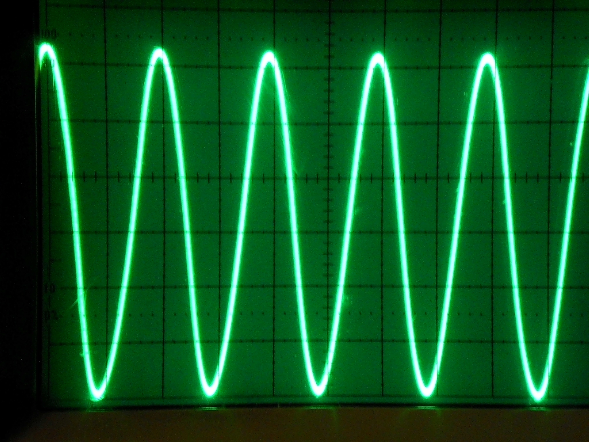

I assume "meter" means your generator?
You arent far off now.
adjust generator to make the scope display get as close as you readily can to one cycle per two horizontal divisions. This will be close enough to use as the 1Khz tone for alignment procedures.
Going to have to repeat this foe each frequency called out for in the alignment procedure.

Something must be wrong. When I adj. the shine knob on the generator to as close to 2 segments as possible on the scope (1K). Then connect the output of the generator to the input of the recorder, and the output of the recorder (set to input mode) to the input of the millivolt meter (with dial set to one) both meters (recorders & volt meter) peg on their meters.:facepalm:
Man... I hate to be-labor this but what's up?

Yes. But now turn the scopes timebase control three clicks clockwise to 50us position. Now 10,000Hz tone will take the same 2 horizontal divisions per complete cycle. :thumbs up:
