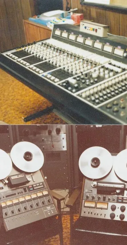

The ATR-700 is a derivation of the Teac A-7300-2T, a half track stereo deck that came out in the mid '70's. I bought one (the Teac version) when they first came out. Time wise, it was right in line with the 80-8, which a bought soon after the 7300, but the two machines shared no electronics that I was aware of at the time.
There they are, side by side, mounted in their custom studio stands. ;)
