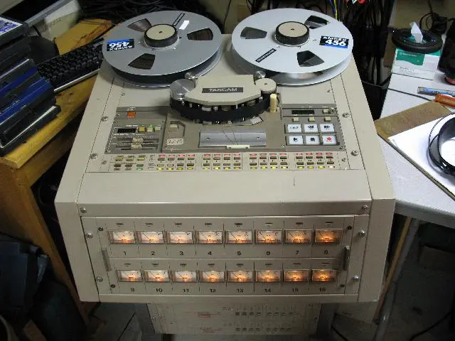

Here is a photo of where it is now.....looking pretty!
--Ethan

Ethan, congratulations on what you've accomplished so far...it does look great.
Wow...I'd be so dashed if I was running into your problems...wouldn't know what to do. It is a real encouragement that you calmly take even the complicated technical issues in stride. That deck will be back into full service for sure.
