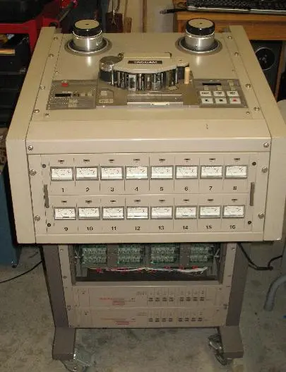

I don't think I can keep up the story line at quite the pace of Sweetbeats but it is time to give the MS-16 I bought a thread of its own.
This is an offshoot of this thread: http://www.homerecording.com/bbs/showthread.php?t=266261
This MS-16 is a 15 ips machine with 2 dx8ds noise reduction units. The heads appear to have very low hours on a JRF relap. The transport has a few noises but is quick and responsive. Rubber is OK but will need some attention in the next year.
I ran some 1" video tape through it as that I don't have any 1" audio tape or even a takeup reel. Then I ran some 1/2" tape without problems and was able to get playback on the correct tracks.
The only defect is that it does not have the track arming panel thus I cannot test recording until I find one. But for the $250 I paid for it I think it is outstanding. (relapped heads alone....)

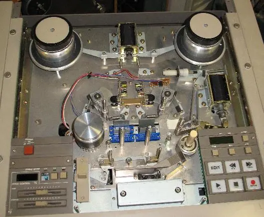

A little time
I've gotten some time to work on this deck. Just general clean up and dusting out. The channel cards are quite dusty so I'll have to go after them one at a time with a fine brush. Today I pulled the top plate and started cleaning the mechanical parts.
Here is a photo with the headstack out.
Oh, This machine was owned by J. C. Penney. Perhaps it was taken care of for most of its life.

J.C. Penny??? What would they want with a 1" 16-track?? :eek::confused:
I love those reel adaptors, and that is a huge tach roller. Looks pretty good, Ethan.

J.C. penneys, that what I thought at first. But it does have stickers for inventory control for the Penneys Audio/Visual department. I suspect that they had a whole in house ad production department....
Yup, a honker tach roller. Ball bearings everywhere.

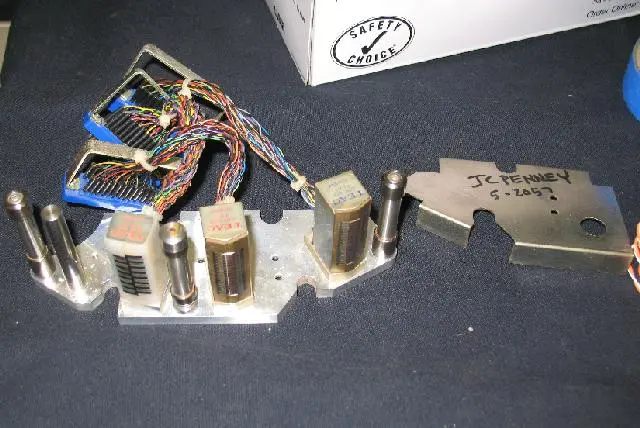

Here are some heads.
-Ethan

Are the guides on the MS16 roller guides? What about the lifters?

The lifters and guides are not roller bearings. Just straight rods. Some say that roller bearings here introduce bearing noise....
THe base plate appears to be a heavy stamping rather than milled. The headstack plate is of course milled.
