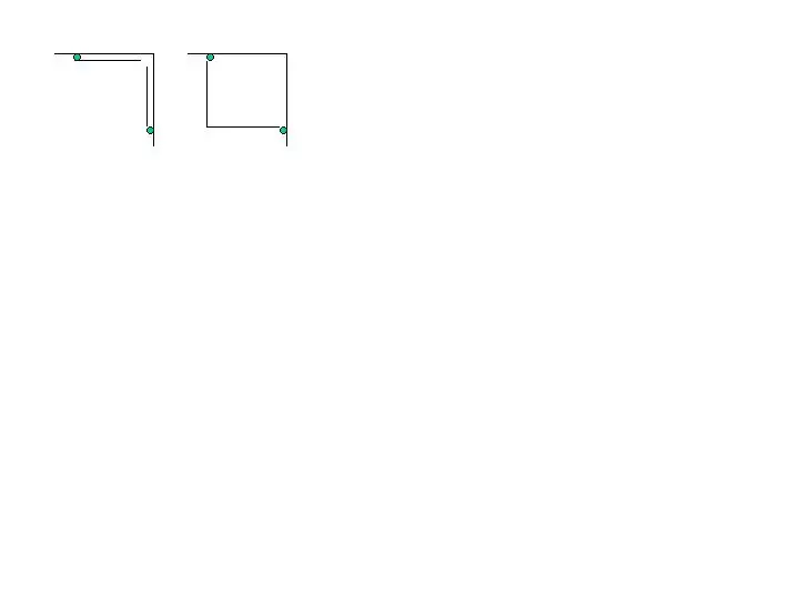

I could see two panels hinged to perpendicular walls in a corner. When they are folded against the walls, you end up with a sound dampened corner. Then you can hinge them away from the corner and make a booth with them as the walls will be opposite of the panels. Would be a lot easier to draw.
Okay, I attached a drawing, but I only had MS PowerPoint to draw it with and no time. So, it might look better if you cross your eyes a little.

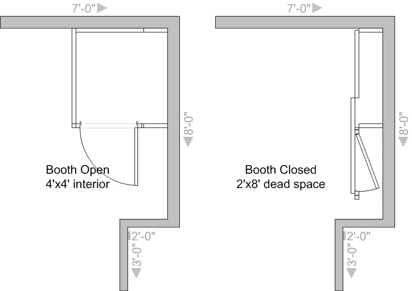

I understand what you are visualizing based on your drawing, no problem. To better illustrate what I originally was going to do with my booth, I cut and pasted the drawing twice into the same GIF, one with the booth open, one with the booth closed. The booth was going to be wedged into the corner of the room because I had this 2' deep x 8' wide indentation in the control room, so there was little I could do with that space (a prior design had four 7' racks there, but wiring was going to be a pain - the floor joists go the wrong way).
Anyway, take a look at the attached picture, and let me know if that helps you visualize what I'm describing. By no means do you have to make a full-blown booth like this drawing, I believe you could easily get away with a single hinged panel or maybe an "L" shaped panel that folds flat against the wall - much like bifold doors, only wider and floor to ceiling.
