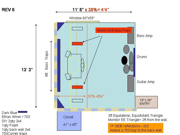

here's my current setup. i highly recommend a RTA and SPL, or maybe borrow one. Once you get things to your satisfaction.... get back to recording.
The basic idea is that you want to create a triangle, with your head being the point at one side of the triangle. So the monitors will be aimed in slightly to create that triangle with your ears.
The inside edges of my monitors are a little under three feet apart. It all depends on how big your room is though and how far from the monitors you are sitting. For me, that distance works well.

To be even a little more granular about it; place the monitors so that the intersection of two straight lines eminating from the center of each tweeter occurs at the center of your head, on the center of an imaginary line drawn between your two eardrums. That will give you the most accurate imaging, it is said. It certainly works with my setup, anyway.. :)

General (very general) rule #1027: set your monitors up to form an equilateral triangle with your head. Many folks - including myself - do put our nominal listening position just a few inches inside that triangle, but you really don't want to squash it much more than that.
