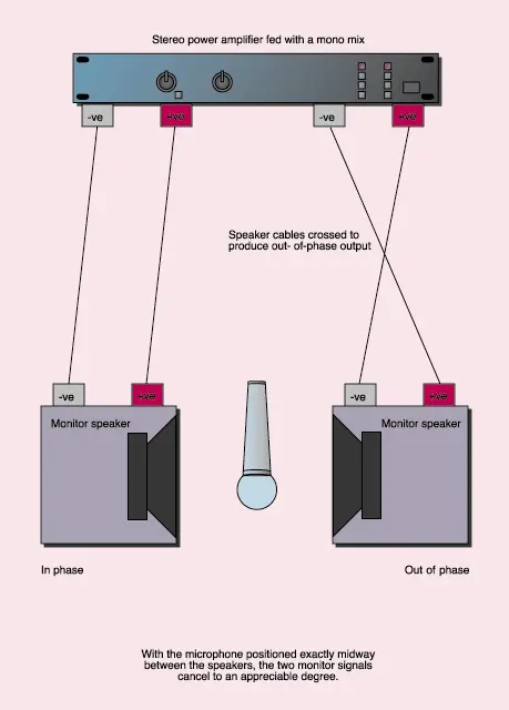

The out of phase thing... yeah... I was just reading up on that. Attached is a graphic and here's the concept in a nutshell:
There are some performers who just can't get on with headphones, in which case there is a dodge using loudspeakers that can be made to work adequately. The basic principle is that the singer's mic is set up exactly midway between two loudspeakers, each of which carries a mono mix of the monitoring signal, but with one of the speakers deliberately wired out of phase — you can do this by simply swapping over the two wires connecting one of the amplifier's outputs to one of the speakers, as illustrated in Figure 2.
If you monitor the output from the mic with the backing track playing, you should be able to further fine-tune its position so as to get a reasonable amount of cancellation, but, because of room reflections and the fact that no room is absolutely symmetrical in acoustic terms, the degree of cancellation will never be perfect. Nevertheless, this technique has been used many times and generally keeps the level of spill down to manageable proportions. Small passive hi-fi speakers or monitors are best for this application.
original article: http://www.soundonsound.com/sos/Jan03/articles/cuemonitoring.asp
Does this mean that placing the speakers in the above fashion, out of phase, will have an even greater reduction in spill than putting the speakers directly behind the mic? If so, why is that?:confused:

Hmm, that's interesting Daniel, thanks for that. I've been running some experiments recording a vocal track on a thing I'm working on at home just using the monitors and no cans and I quite like the result. It's bled alright but somehow it sounds smoother and more, ah, "expressive" for want of a work when it's mixed back in, bleed and all, than the cans versions I've done.
I've not reverse phased one of the speakers yet and it was stereo monitoring not mono. I can mono the monitoring chain and reverse phase one speaker so I'll do that tonight see if that does a better job than what I've already got down.
Well I've been experimenting with a track I'm noodling about with (relatively low volume ballad) and this is what I've found so far (with the apparent monitoring volume feeling about the same in all three cases);
1). Closed Ear Cans - only very light high frequency spill on the track and no personal problem using them.
2). Stereo in phased monitors pointing at the back of the LD condenser (cardioid) with an Auralex square between the mike and the monitors and no cans - noticible full frequency spill on the track and no personal problem using monitors.
3). Mono out of phase monitors pointing at the back of the LD condenser (cardioid) with an Auralex square between the mike and the monitors and no cans - cancelled bass frequencies but still noticible high frequency spill on the track and no personal problem using monitors. Less spill than option 2.
4). Mixed track result; - no noticable spill in the mixed down stereo track from any of the 3 takes. Either of them sat in there just fine. I chose the one that was the best vocal performance which just happened to be number 2.
So, no reason not to use 'no can' tracking as a viable method and the mono out of phase thing defintely reduces spill and, if Daniel's document is followed vis a vis placement, it would probably cancel out the high frequency spill as well.
I've not bothered to set up the monitors mono / out of phase / left and right placement of the mike like Daniel's picture and I don't think I'll bother. I was happy with all three methods tried.
