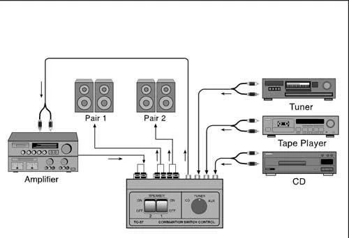

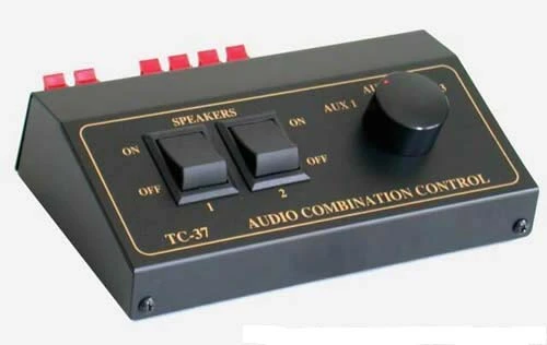

This really is a useful well made unit for dirt cheap...
(there should be 2 pictures here...)
