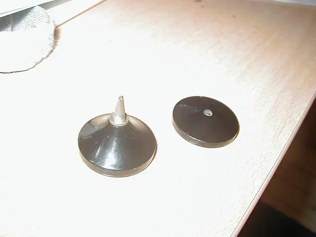

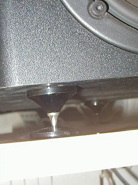

maybe another idea:
i use those 'spikes' like they use for hi-end hifi-speakers. that keeps the bass response pretty tidy!
if needed i can post a picture.
okido...
here's my 2 eurocents ...
spikes ...
btw: the 'better' hifi-stores have 'm.
you don't need four per monitor, 'cause they might go rattling.
three does the trick!
also: see the picture for the close-up!
