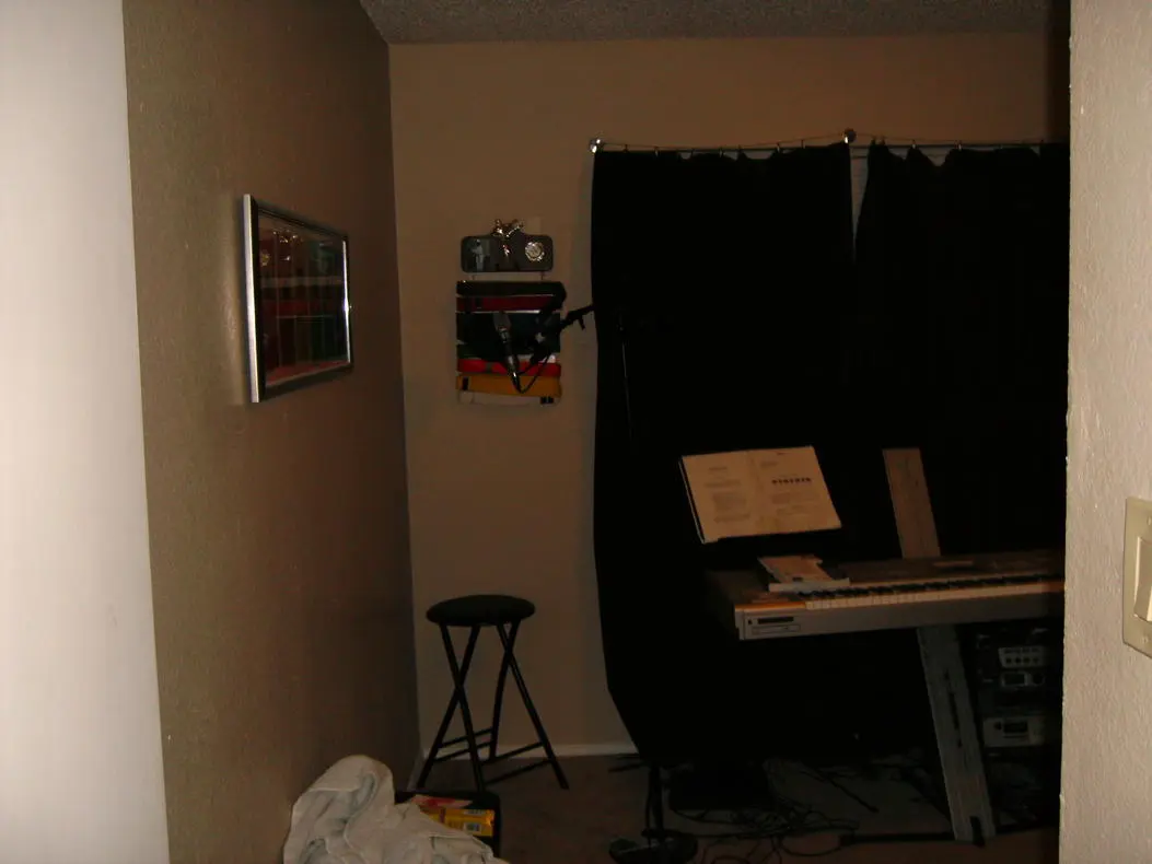

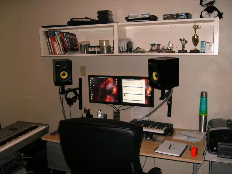

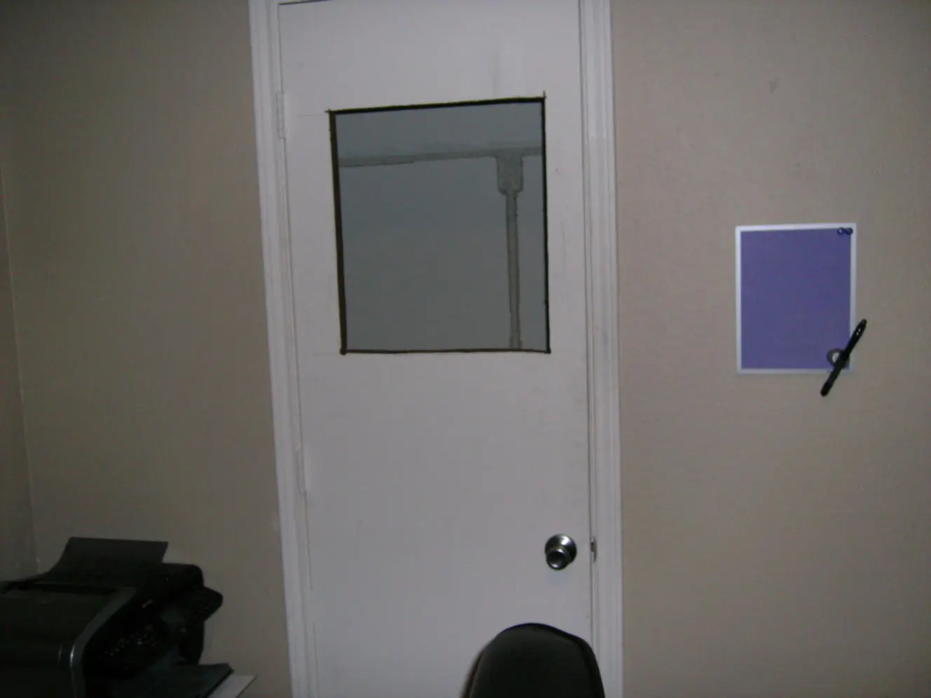

demi...do me a favor. Take pics of your recording area and send them to me. I might be able to suggest some things that could help you out.
quite possibly on the cheap side too if I might add.
F to tha I to tha E
F to tha I to tha E
Here are the pics of bad recording central. I took down all the rigged up sheets from the ceiling and ripped out all the wall covering from the closet...formerly called the vocal booth. i now need to buy a new door... for the closet and shelves... to make it a closet again... because it's definately not a vocal booth. I am also in the process of reading and gathering information on placement of wall panels... i've got to spend some money to get a better sounding recording space.

I've been reading Ethan Winer's website on acoustics and it's really good information. He also suggested how to repair the vocal problem in another posting on the board. That DIY rig is very simular to what i had going with the heavy blankets and sheets. I think i'm going to just shell out the cash and get the wall mount panels and call it a day. I am also going to get a reflexion filter... or a portable vocal booth
I have also learned from this that good sound is also a learned effort. I am going to have to spend alot more time in perfecting the mix and getting a good track take from my performers.... in the beginning. I'm also looking at getting a different condensor mic for my vocals. The Rodent1a has a low noise shelf, but it also sounds different with different voices. Better yet if i take more time in listening to how they sound i can get a good mix with the equipment i have... just need to fix the room reflexions... :o)
