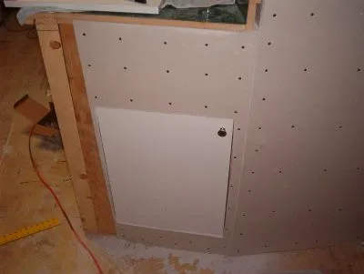

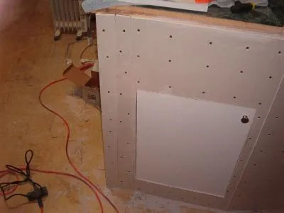

I decided to sheetrock the side of my producer's desk, and slide the countertop over the 3/8" to cover it. Sheetrock just looks so much nicer than painted plywood could ever look, so this works out.
Also, this gives me a 3/8" lip on the other side, for mounting an angled countertop that matches this one, for the last rack I haven't built yet.

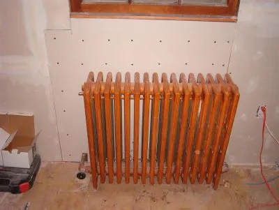

Picture 172.... cleaned up behind the radiator. was insulated and plywooded in an earlier picture, now its finished.
Buzzed drywall screws between the radiator coils using a 24" long bit extension :)

Picture 173.... producer's desk sheetrock done, time for mudding!

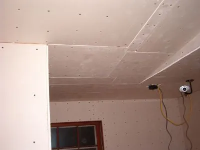

Picture 174 - the ceiling is finally finished, from a sheet rocking perspective. A little bit of a patchwork quilt, but since my cousin does most of the taping, I'm cool with it :D
When he saw this on friday, he looked up and sighed, poor guy.

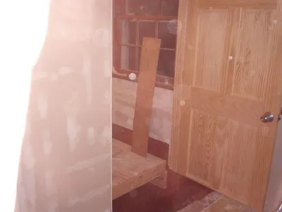

The start of installing the vocal booth door. Had to notch the window sill, and put a support behind it.
This is what happens when you build a vocal booth over a stairwell :D

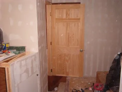

Door mounted, and in the open position.
Yes, I lopped off a lot off the bottom. One of those things, but it clears the top of the stairs now. I discovered this after I screwed the door in, while in the vocal booth, and couldn't open it all the way. Just enough to buzz the screws in. Duh. But its fixed now, and closes tightly.

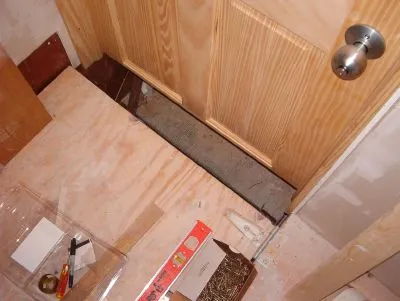

Another view.
Can you see the major fuckup yet? :D
Here it is in all its glory.
a 5" gap on the left, and a 6" gap on the right.
A GAP!!!!
Easily fixed though... I think... its a matter of extending the platform with a hinged piece so that it can support the weight of someone stepping on it, as well as providing a smooth surface for a double-edge wiper type of weatherstripping for the door.
I can also use this flap to seal up the entire stairwell, so one doesn't have to step down one stair, then up into the booth. I've been looking at these stairs for a few months now while doing all this work trying to figure out an easy way of making something that just rests on the stairs that completes the floor, but is removable. So, we'll just hinge it so the one side is supported by the flipfloor, and the other side rests on the top step, and I can pergo all of this so its matches the vocal booth floor as well as the room floor.
Of course the vocal booth floor is 53/64ths higher than the studio floor, but thats okay :) I'll use some moulding to make make the ledge a more smooth type of line.

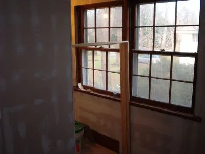

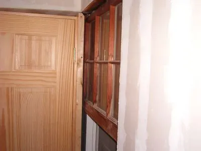

179 - last picture for today.
Its difficult to see, but there is a 2x4 that the doorframe is screwed to... and that 2x4 actually is in the window frame, using 3" long deck screws, and structural adhesive. Its definately not going anywhere. had to remove some of the moulding on the windowframe so I could tie it in a structurally sound manner. Window works, door works, and there are no airgaps in this area. Will be chaulking it today both sides, then applying moulding later so it looks like its supposed to be this way.
BTW, the right answer would have been to remove the two windows, and finish up the wall.
But noooooooooooooooooooooooooooooooooooo.
Once I figure out the floor gap issue, it will be fine. Clever use of angles, double bladed rubber weatherstripping even if I have to route notches and glue it in, whatever. It will be fine. I insist.
