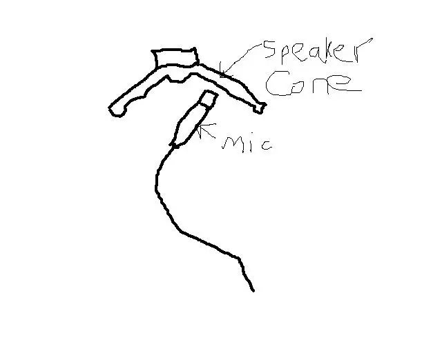

There is no magic fix. Lots of trial and error until you find the right spot for the mic are in order. I would start with the AT dynamic (or go to a music store that rents live equipment and rent an SM57 or MD421 for the session). Put the mic very close to the speaker (say 1-2 inches from the cone) and angle it so it is parallel with the inside of the cone. Placing it near the center of the speaker will tend to give you more high end (which can be harsh). Moving it out toward the edge wil give you a mellower tone. Wear headphones while placing the mic, so you can hear exactly what the mic is hearing. Have the guitarist play something while you move the mic around to find the "sweet spot."

Scrubs--perhaps I did not understand correctly where to place the mic.
When you say the cone of the speaker, you are talking about the very center, correct?
Is the inside of the cone just to any side of the cone, being slightly offcenter?
No, I actually meant the wall of the cone. If you aim right at the center of the speaker, you will generally get a harsh, treble-heavy sound. As you move out toward the edge of the speaker, the sound gets mellower and more bass-heavy. Try to find a happy medium for your particular speaker by starting at the center and moving out toward the edge until it sounds good.
Here's a terrible illustration.

PS., Thanks for the illustration, scrubs, as crude as it is, very helpful, thanks.
