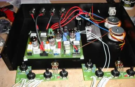

There are also Many "NON-Kit" pre amp projects that you can do....
There are Quite a few Pre-amp Schematics and PCB Designs on the Net that you can use to Etch your own PCB"s and Just source the Parts yourself ,which is what I"m doing with my "Green Pre" Project.....
The Green only costs between $50 and $75 per Channel to build and the Info avaiable on the net is very extensive and you don"t need to be an electronix genius to build one as I have never built anything like this before and Every one who has built one says that the audio quality rivals some of the best Mid to high end Pre"s.....
Here is a Pic of my Not quite complete Pre amp, I just have to wire up all the switches an XLR"s and LED"s and Mount it in the Box and test it and Make a Heatsink For my PSU....
Cheers

Nice lookin' work :)
Of course another reason for the DIY route is that it's good fun not to mention fulfilling.
It's nice to work with gear that you know intimately, if you've built it yourself you'll know every nook and cranny inside the box and if something does go wrong with it you have a good chance of being able to fix it yourself.
In fact "it's cheaper" is probably the last reason I grow my own.
Yes the 'green' is an incredible pre cosnidering what it costs you in parts. The circuit is based on the pres found in the Amek Mozart console, very clean.
My current project is the Gyraf G9, a 2 channel tube pre. High voltage and transformer balanced; just valves, transformers and passives in the path (although there are some semiconductors in the PSU). Just waiting for my front panel and I'm planning on wiring up the torroids today.
