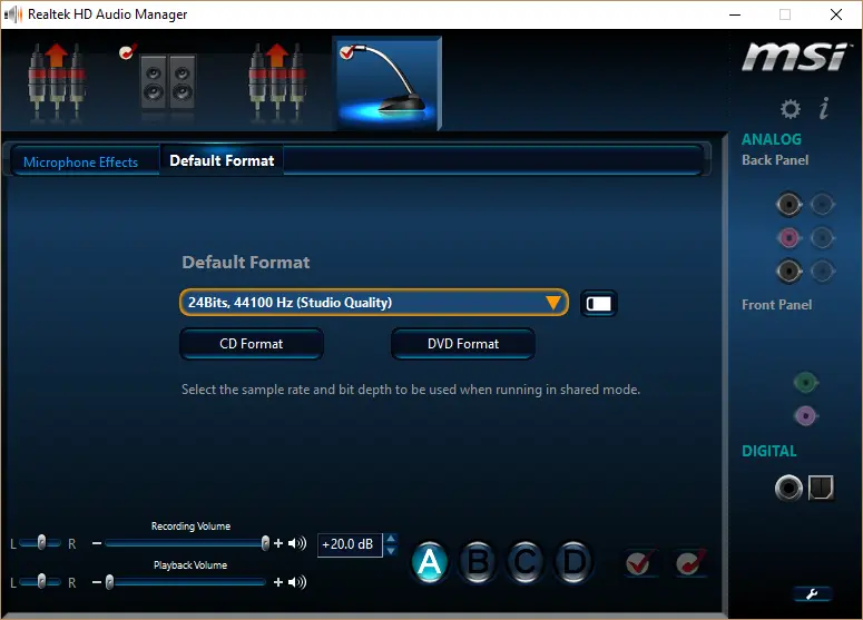

Sorry if I put this under the wrong section but I am just trying to stop my microphone from hissing. I got a $25 Amazon gift card from my friend and I really needed a new headset. I bought this thing Amazon.com: Turtle Beach Ear Force Z11: Computers & Accessories and I found out that my microphone hisses. I read the manual and it says that the microphone recording frequency is anywhere between 50Hz and 15kHz. I opened Realtek HD Audio Manager and I couldn't manage to get the frequency below 44.1kHz. Some help please. I just need to get the hissing to stop. The quality is fine just the hissing is annoying.

Don't worry about the 44.1kHz. It's meant to be set to that, regardless of the microphone frequency response, and isn't going to be related to your hissing.
Try getting the recording volune to 90-pct, not +20. And make sure all the MIC and sound effects are off.
EDIT; also, shared mode might introduce noise
Sorry, I'm not very educated in mics. By 90-pct did you mean moving the recording slider to 90 and removing the +20? I did that because the mic sounded quiet and I didn't know what else to do.

Yes the same is true for me. I tried using skype on my phone and there was no hissing. Does that mean that the adapter is bad or that is is low quality?

Really I think it just means the headset mic isn't sensitive enough or the microphone input isn't clean enough...or both.
I think all you can do is make sure the mic input level in windows is at 100, boost is disabled, the mic isn't unnecessarily far away, and you're speaking loud and clear.

Time for some reality. Cheap mics are noisy compared to better ones. Realtek sound chips installed in computers also add noise (hiss) to a signal, especially when the levels are turned way up because cheap mics also tend to have low level outputs.
To be rude, any solutions that try to help are polishing the proverbial turd. A better mic and even a cheap external USB audio interface will magically remove the hiss. Of course then the problem becomes the acoustics of your room. but that's another post.
