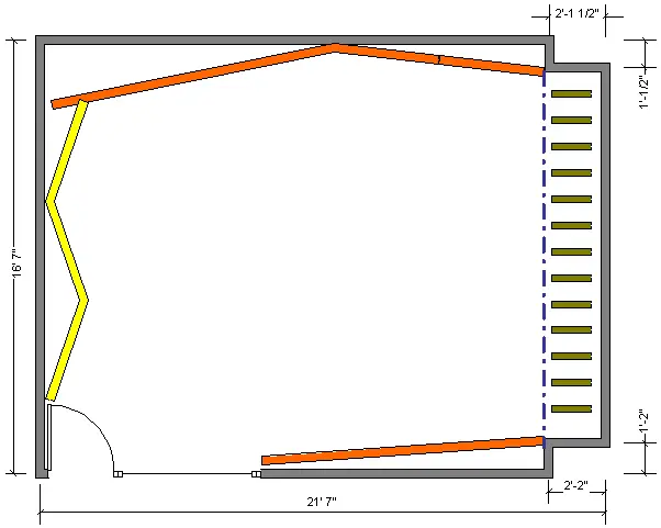

Long time reader, first time poster here. I work as a sound designer for a computer game company. Due to many factors, I finally have a space dedicated to recording my foley/vox work some live instrument recording with a modest (!) 10K budget to spend on materials and labor, some of which I will do myself. We have just recently finished ripping the carpet out of the roughly 17x22x8.5' space (metal stud, drywall/drop down acoustic ceiling tile) and are ready to put the laminate flooring in. Meanwhile, I have been poring over all of my resources and scouring the internet for more information on how to tackle the acoustics of the room. A minor/major factor in my plan is the ability to re-use the majority of acoustic treatment when we inevitably move in three years, once our office space lease is up. The shape of the room lends itself very well to a short wall of acoutic hangar bass traps and then some bass trap paneling angled down the long walls. I may or may not want the panel traps to be full height, the major factor there is access to outlets and network ports. The real problem for me is figuring out how much diffusion to put in and what kind. I really don't quite understand the resonant slat diffusors (yet) so I am loathe to spec them, and I am sure I can do couble duty bass trap/diffusion on most of my panel traps and even on the low bass hangar area, but I just don't really have the feel for what is the right amount.
This is a live only space, any monitoring done here will not be critical.
So, whaddya think of this plan?
Grey=existing walls
Brown=bass hangars
Yellow=diffusion panels
Orange=bass/mid-bass panel traps
Should I treat the 5'4"x7' window?
Should I include hangars behind the angled panel traps?
Should I angle the panel traps at all (or maybe sawtooth them)?
Thanks for lookin,
Scott Petersen

"Should I treat the 5'4"x7' window?" -
Probably not. you may want to record dialog, and having a live surface your vocal talent can speak into from a few feet away with a directional mic canceling out most of the return from the glass will give a bright sound but still controlled.
"Should I include hangars behind the angled panel traps?" -
No, panel traps need rigid fiberglas or mineral wool about 1 inch behind them and fixed. it's part of the design parameters.
"Should I angle the panel traps at all (or maybe sawtooth them)? " -

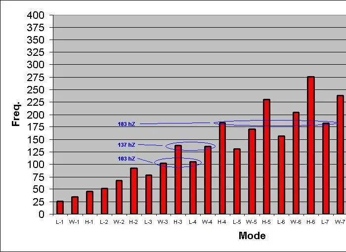

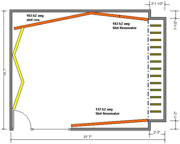

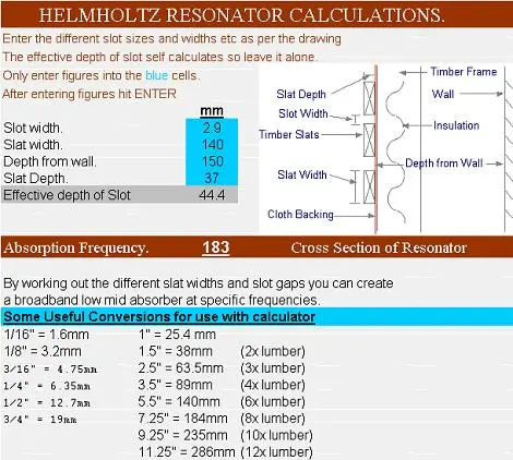

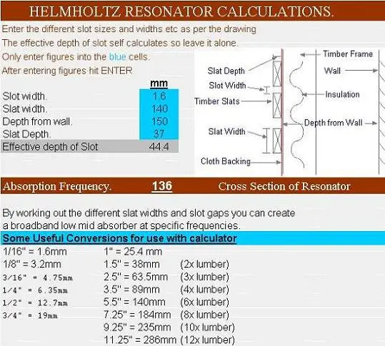

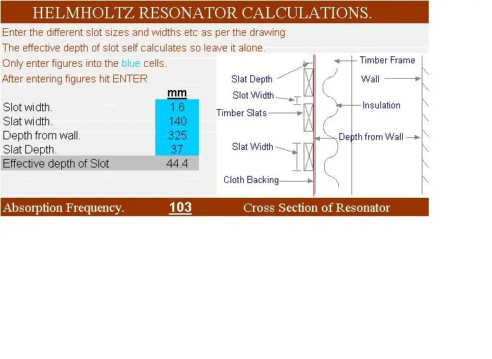

Actually, rather than use panel traps there I would suggest building slat resonators which are tuned to the three frequencies your modal dimensions will most exaggerate, which are 103, 137, and 183 hZ (see first attachment, ScotPModes2.JPG, and the specs for all three resonators, along with a markup of your plan showing where they should go. If you want to keep these portable, you can build two of each that are half height, then stack them. That way they will be movable (except for the 103 hZ one, it would still be a bit large)
You can find basic plans for the design of these here
http://www.johnlsayers.com/HR/index1.htm
Although at least one of the measurements in the corner absorbers isn't quite right for 45 degree angles.
Doing the room this way will give bright areas, absorbed areas (the right side mostly) and if the overall room is too bright, you can always hang 1" rigid fiberglas over some of the slots without losing the effect of smoothing out your modal problems.

Here's the room
And the first absorber
The second absorber
The third absorber
Your room modes, with problem areas circled -
