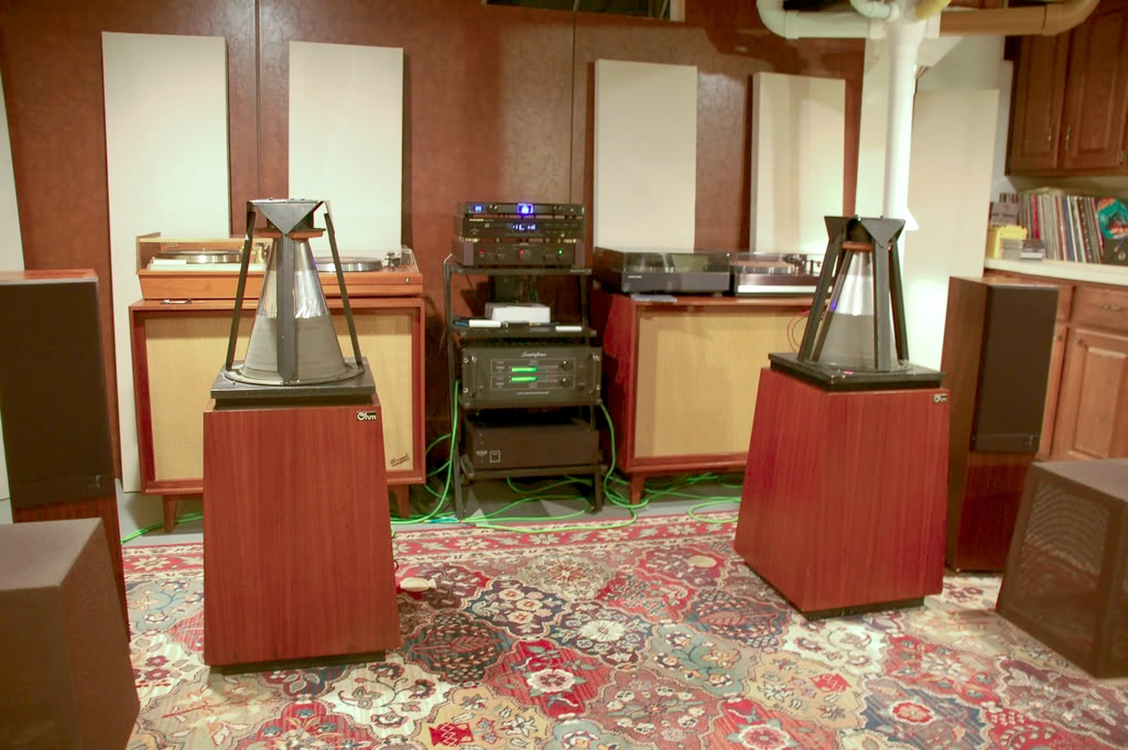

Well, we recall how painful it was watching KEF and Bowers go through these gyrations : )
