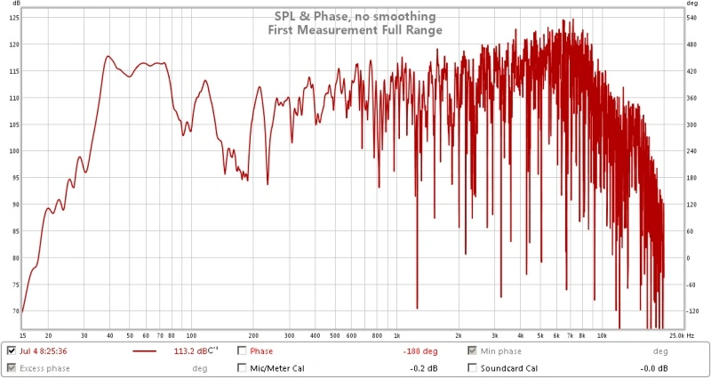

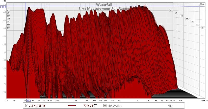

Full Range Graphs
More graphs

Kit resonances, and acoustic guitars WILL affect the sweep.
Can you post the .mdat? I like to be able to really LOOK at the data. My brain sees those graphs and says, 'uhmm, yeah - so what.. squiggly lines.. nice..." :facepalm:
Besides, the jpegs get too fussy for me when I zoom, and if I'm not wearing my glasses - Forget IT!

Thanks John, I moved one of the absorbers to the ceiling above the mixer and built new monitor stands. I took a new measurement at my listening position, I will post the mdat file later when I get home.

Hi John, I can't attach the mdat file, the format is not supported here. I will try to email it to you.
