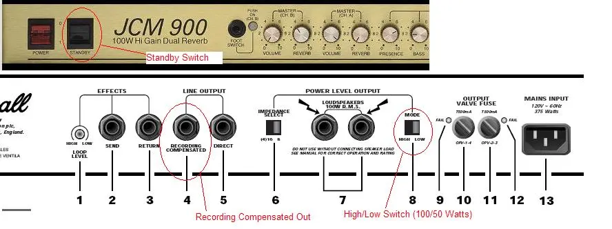

This is a Marshal 4100. The rocker switch I was talking about was the standby switch. When I turned off standby (and engaged the speakers) I got the hum. When I flicked the High/Low Output (50/100 W) switch in the back, it fixed the problem.

There seems to be a lot of miscontrued information here so I will try to clear it up.
1) The standby switch is the on located on the front of the amp, next to the power switch. With standby engaged there is no sound coming out of the speakers. With standby turned off, the sound comes through the speakers.
2) I did not mod this amp by putting a switch between the speakers and the head. Other than the soldering done by the tech (shown above) this amp is prety much stock.
3) The "Recording Compensated" output jack sends the preamp + effects loop signal out of the amp head. I run this to the board.
4) With the standby engaged I still get signal out of the Recording Compensated output jack on the back of the amp.
5) I don't need a dummy load with standby engaged. The speakers are connected to the amp they just don't put out any sound when it's in standby mode.
6) The switch I was toggling refers to the High/Low output switch on the back. Toggling that fixed the hum problem and the tubes stopped glowing bright orange.
Hope this will clarify....

Thanks for clarifying. As long as you stay in standby mode, you should be able to run the amp with no load.
ok if that/s true then the mod must have been to not lift the B+ from the preamp tubes when the standby is on...as normally happens with a standby switch...
Nope - these are the mods done to the amp (below - taken from earlier post in this thread) and that wasn't one of them. The ability to get signal out of the Recording Compensated jack when the amp is in standby has always been there.
