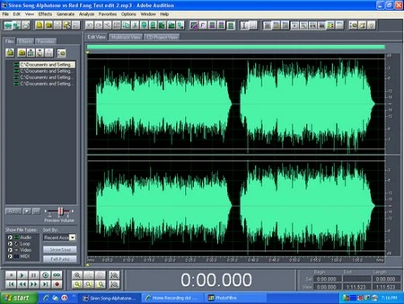

Here is a follow up to the Red Fang speaker post. Both solos are back to back with a few seconds of silence in between-first is the stock speaker then the Red Fang. A Fender Strat with a GFS Retrotron bridge pickup is used in both solos-the Red Fang is substantially louder.
The screen shot shows the actual waveform amplitude difference.:eek:

interesting. what amp?

Just check out the screen shot I posted and the difference in the peaks from the stock to the Red Fang-or the volume difference in the sound clip..
