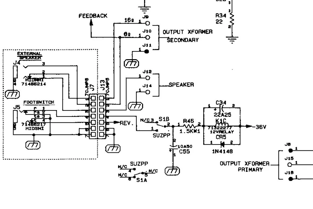

There is an Ext speaker jack but the manual does not make it clear if plugging in there disconnects the internal speaker. You can test this, power the amp up and put all controls to minimum. Now put Mk1 lug against the speaker and you should hear a bit of hiss and hum. Now plug a jack into the speaker skt, anything will do, a guitar lead sans guitar. Does the speaker go silent? If so, NBGood then. If not get the Behrry box!
Plugging into the 'Ext Speaker' jack does disable the internal speaker according to the amps schematic. Internal speaker is on the 16 ohm tap, external on the 8 ohm tap.
