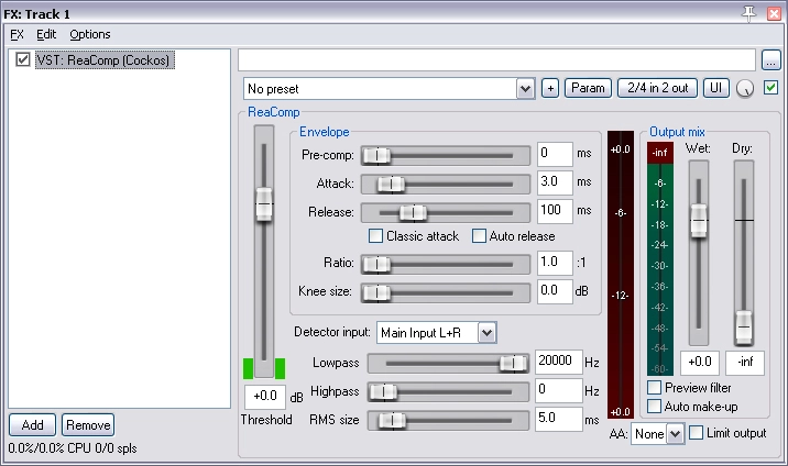

Makeup gain is always after the compression happens. It doesn't make any sense otherwise. If you haven't done anything to it yet, what are you making up for?
That said, can I please see an example of a comp with both variable makeup gain and output level? A lot of them offer automatic makeup gain and then an overall output. This can be useful when you're really digging in with a lot of reduction. Automatic makeup should bring it back up closer to its original peak level, but now that the RMS level is higher, that might be too much, so turn it down with the output knob. Why not just turn up the output control? Sometimes they don't offer enough upward adjustment.
Sea Reaper's compressor below. No input level control, but there is the auto make-up button, and an output level control.

ReaComp's automatic makeup is definitely post-compression.
