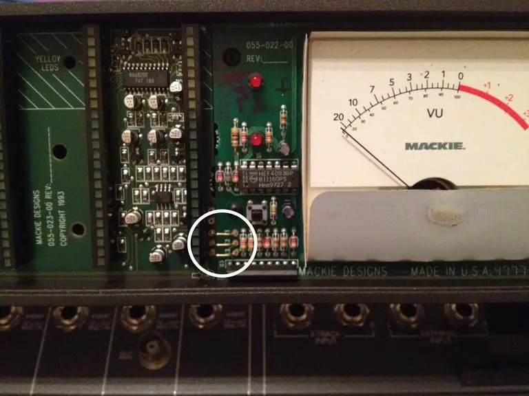

Hi, i bought this item used off ebay. major functions seem ok, but the meter bridge is not working as expected. There is a switch to select from tape/source, so you monitor either the channel after the fader or the tape inputs. You press the switch and the LED comes on and off, but the function doesn't change. It is ALWAYS monitoring the tape inputs, not the channel (post fader). Has anyone seen this ? any ideas on what to check/where ?
thanks
found the problem :)
is anyone familiar with these gold connectors? they were lost. so i replaced that and voila, now the channel/source switch works. good to go :)

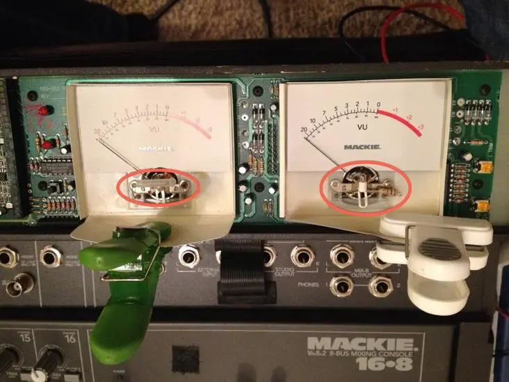

Replace VU lamps on mackie 8 bus meter bridge

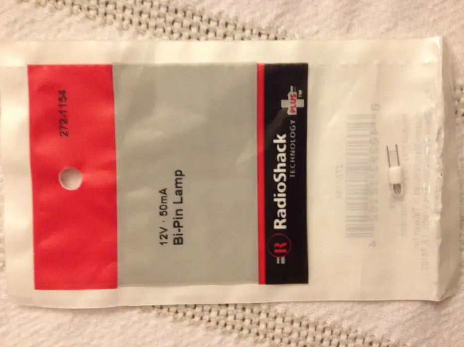

Also i just replaced the VU meter lamps as well, in case someone needs it, as the factory ones go out too easy. THis is an easy repair with parts from radio shack.
First, get a proper lamp, they are 18V lamps. So i got a 12V 50mA lamp from RS
I used a 150 ohm resistor in series to get the voltage down (i calculated it to hit 10.5V for the lamp so you get more life out of it).
Then use a couple of cereal bag clamps to hold the plastic covers of the VUs then just solder it and position properly, leave some space in the resistor terminal.
On the left side you can see the original lamp, on the right the new one with the resistor. IT has to be a 1/2 watt resistor btw.
Just posting this in case someone runs into this problem.
