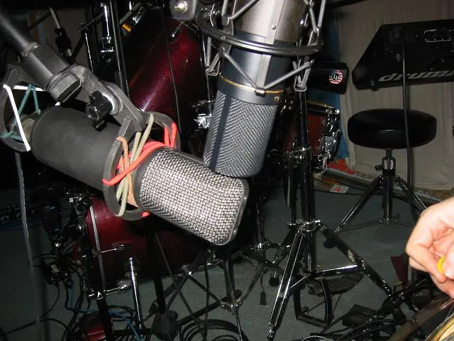

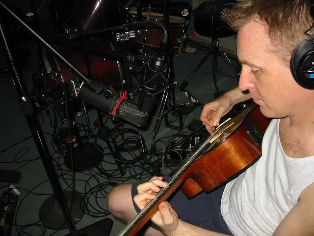

I've started experimenting with M-S micing using the M-Audio Octane. Here are some pics from last night's session. I was wondering how this placement looks to those who use this technique regularly.

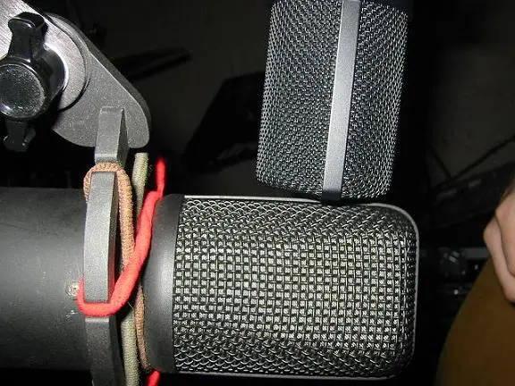

NOTE: The close-up of the mics (last pic) is where I ended up recording. The cardioid's diaphragm is centered above the figure-8's.
EDIT: That's my buddy Darrel playing his Fender acoustic.

And the close-up.....
Yep - looks familiar! :)
The only difference is the mic placement that I use, where both mics are vertical, with the figure 8 mic (SP B3) right-side-up (on the bottom), and the uni (SP B1) is upside down (on the top), with the tops of the mics almost touching. I would think both configurations render the same sonic results.
Try it with a drum kit too. ;)
Your shockmounts look like mine!
Nice pics...I'm gonna start doing some mid-side on drums in my new house. Baby Bottle as the mid mic, at4050 as the side, with an Audix d6 on kick.
Thanks for the picks! Makes understanding the setup easier!
I've wondered about this. How would you place them for drums? Out in front? Overhead?
I've been wondering the same thing. Since mine will make up a good deal of the drum sound, I'll probably put them a couple of feet out front, maybe 4' off the ground. I think over the drummers head, angled downward, would probably also work well.
I position them in front of the kit, at ear-level. It's scarey how great the imaging is! ;)
